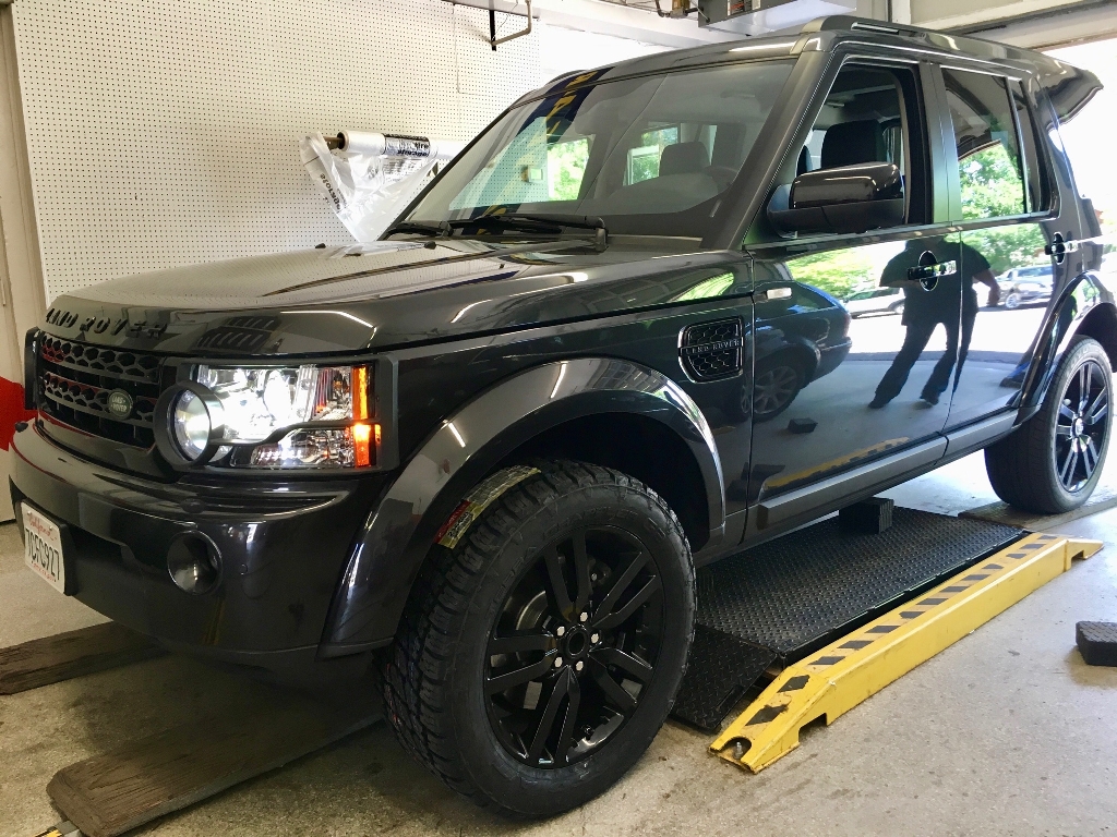

NICE! Is that stock height or with Rod lift? I am currently stock with no rod lift and debating on 265 or 285. If its only minor rubbing when its new, I want to step it up and get 285s. Will 285/50/20 work with stock? Thanks
@ProTonez The rubbing only occurs when the wheels are turned just before and at full-lock. I wouldn't say it's loud, but you can hear it. For instance, you wouldn't be able to hear it with the radio or A/C on at certain levels.
I haven't seen the 265s in the flesh so I can't really comment on them, but the 285s are indeed a very noticeable change and look great. I personally like more sidewall as opposed to a wider track, so I would've opted for the 275/55s had they not caused more serious rubbing issues, but I am very happy with the 285s.

Are you running rod lift? I was wondering if you can run 285/50/20 with stock height with no lift. Thanks

Using shortened sensor rods is not a "lift" nor do they magically alleviate the issues caused by larger tires.
285/50 may rub or be very close to the upper control arm depending on the wheel offset and width. 285/50 is really not an ideal width for wheels narrower than 9-9.5". It would be a very poor choice on 8-8.5" wide wheels.
FYI: Not all factory 20" are the same width. Mine were 9.5 and barely enough offset to not slice the inside edge of tire against UCA.
*Guess what else, the "rod mod" actually makes this issue worse, not better, because as the vehicle sits higher, the gap between tire and UCA closes....rods are pretty much problem creators, not solvers.

I think I have asked you your thoughts in another post, JWest. I use the term vernacularly, as I am not a fan of rods either (in other words, I liked the stance of the vehicle, so I was trying to determine the magnitude of lift in the photo. I intend a slight e-lift to help with the fitting of the tyres in the wheel arch.
