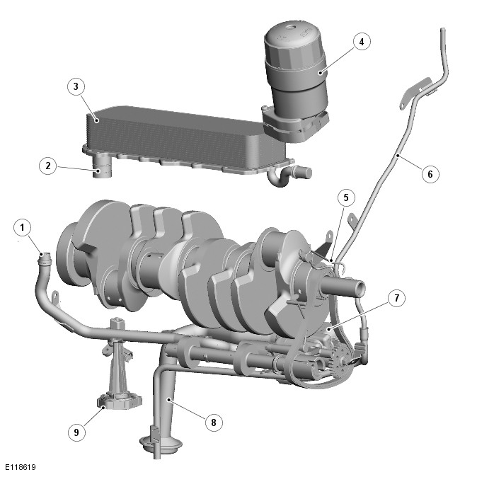

I'd be surprised if there were more than a couple of teaspoons of oil draining from the plug of the LR4's pan after vacuuming it out from the top of the engine, but I have a thick, heavy and ungainly Asfir sump guard covering that plug on my LR4, so I don't plan on removing it just to prove your indy shop wrong upon my next oil change... :biggrin: It would be interesting and educational if someone tried that, though. I have heard this argument before and I think it's BS personally, mostly because old habits die hard. Land Rover has both draining and vacuum draining procedures illustrated in its workshop manuals, and they don't specifically favor one over the other, either. The extraction tube runs all the way down to the very bottom of the sump, below the oil pick-up, so I think there would be very little - if any - extra oil left in there if/when you remove the drain plug. Here is a diagram of the lubrication system (6 is the extraction tube, you see how it runs from just under the oil cap to the very bottom of the sump; 8 is the pick-up, 9 is the oil temperature and level sensor that's secured to the bottom of the pan):

His claim that he is able to check for leaks while under the truck performing an oil change has some merit, though.
If you are concerned about warranty issues, stick to the Castrol EDGE Professional OE Land Rover recommends until your 4 years or 50K miles are up. It's an extra 40-50 bucks per change to use that oil over Mobil 1, not the end of the world in the grand scheme of things.
