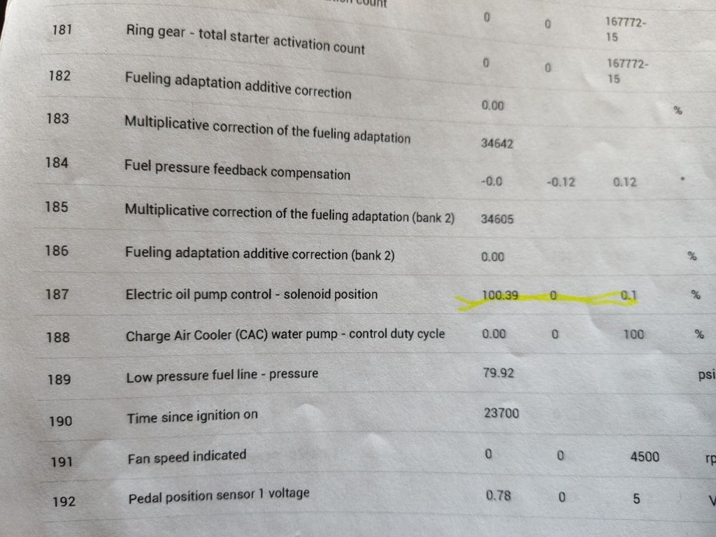

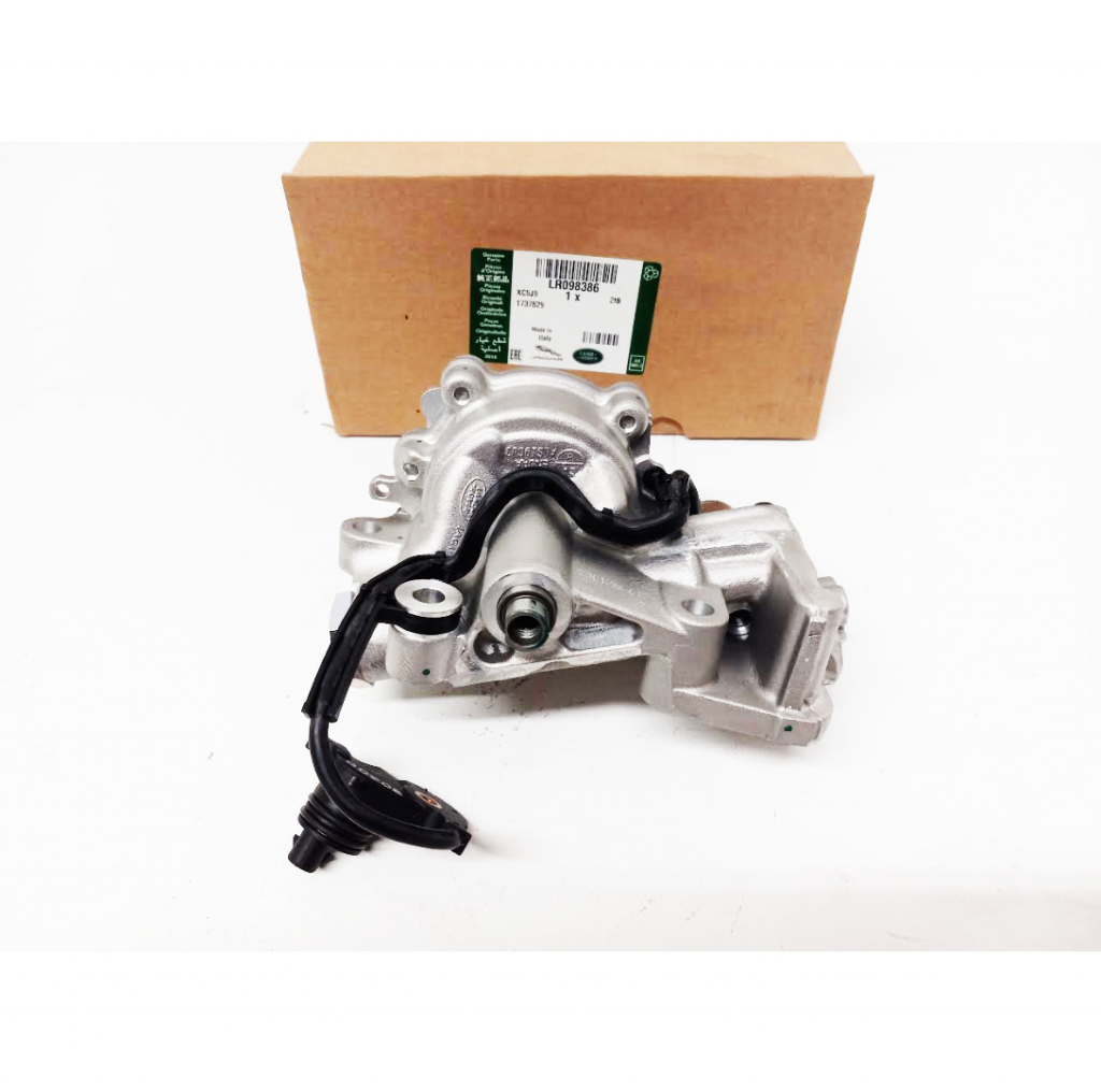

No oil pressure sensor. Oil pressure is not monitored.
To test the oil pressure, you will need a tool like this. Or, find another oil filter cap and drill a hole in the top to screw in a guage.
