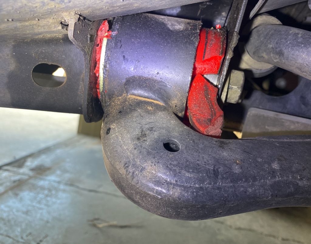

Well, I made it to Moab and back, and the only major problem I had was destroying one of the new poly bushings in a front lower control arm on one of the trails.

I've got the poly bushings in my lower control arms as well. I notice they make quite a creaking sound when my front wheels articulate. Wonder if there is a good way to grease them?
I thought about fitting zerks to the A-arms, and grinding a channel around the perimeter where the grease might go. But poly requires silicone lube, which isn't easy to find in a tube. I'm not sure this was a lube problem, though: the ******-bearing part of it seems to have gone first, and is what fell out on Hell's Revenge. Then the rest of the bushing seemed to start coming apart inside, too. The other side seems to be fine, so hopefully I just got a bad bushing. IDK.
The only way I know to grease them is to pull them out and lube them inside and out, then reassemble.

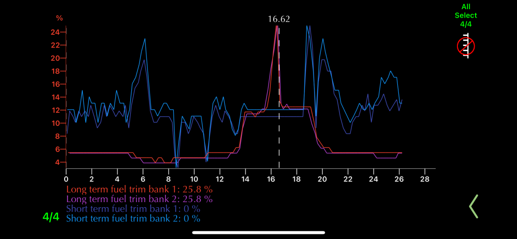

Reviving a very old thread, because the issue was pretty persistent this last long trip. It seems like trips of a few hundred miles start the behavior up.
I've attached a log I recorded when I believe this was reliably happening. You could clear the code in the GAP tool, and it would immediately reappear as a pending code even though the CEL wasn't on yet. Does anybody recognize a pattern in this data that might help point to the source of the issue?
