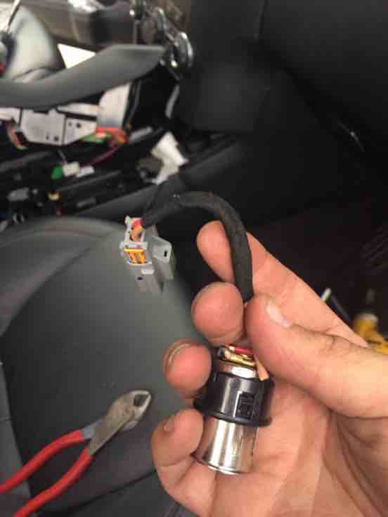

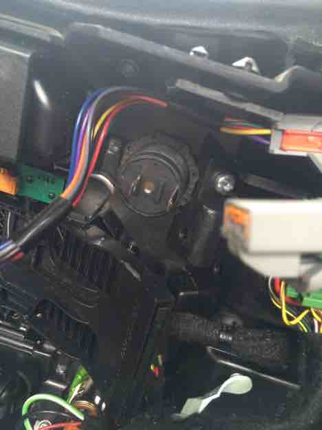

So while I was installing the HAM radio in to wifey's LR4 I decided to fulfill one of my planned upgrades, a permanent dual USB port in place of the 12V port in the center console. So I popped out the stock one and popped in a blue sea dual USB (minor trimming of the console required). Crimped on some female connectors and popped it all back together. I used red as positive because the other was brown and that seemed to be correct. So when I got everything back together and turned on.....no power to the USB port. Great, pop off the console again and all the wires look legit. Disconnect the pigtail from the port to the main wiring and there is good continuity. I do have the truck running by he way. Then I check for power from the main harness and nada, zip, nothing. This is for the passenger side, driver's side is fine. I check the fuse for the port and it is fine. So now I'm stumped. I haven't checked the relay (and not really sure how to do that) and I haven't rechecked red from the main goes to the red through the connector. Any thoughts??

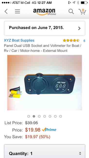

Dual battery for sure. I added the Traxide system and a few 12V ports. Next add on is a dual USB and volt meter for the rear cargo. I used this one in my 110 and love it. Currently the system is sitting on the bench waiting to be installed. ImageUploadedByTapatalk1433921280.435163.jpg

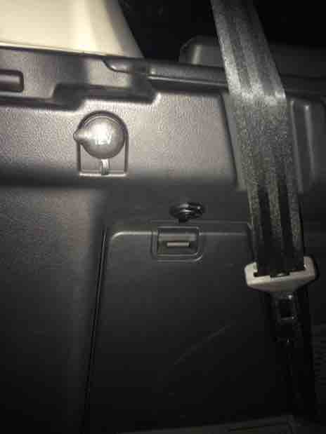

You can separate the 2 components so as to hide them better. I'll stick the USB port next to the 12V I added and the voltmeter close to the OEM port where it is more visibleImageUploadedByTapatalk1433921405.029231.jpg

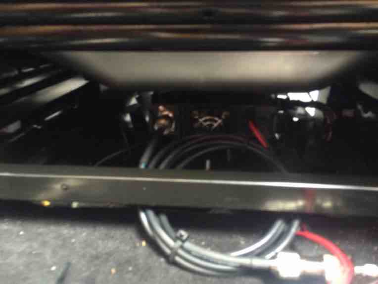

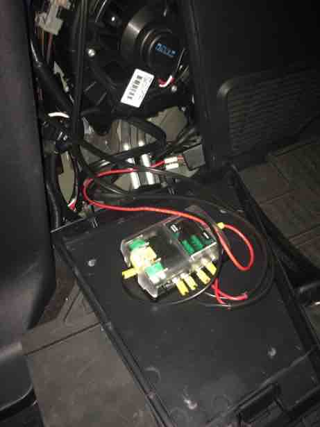

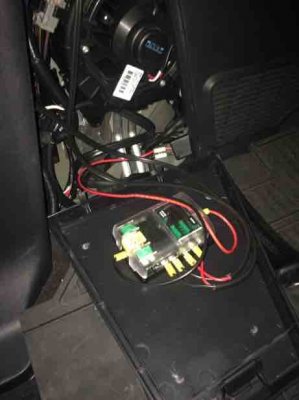

Happy to share. I started w the dual battery kit and placed a fuse block in the rear storage area on the driver's sideImageUploadedByTapatalk1433997493.303373.jpg

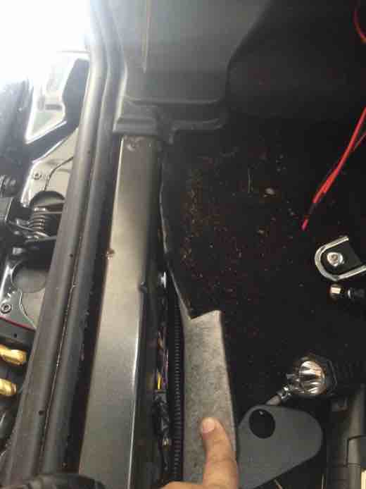

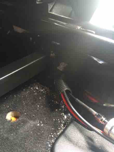

Then I ran power across the rear tailgate hinge to the fridge port and for the HAM radio which was placed under the passenger seat. ImageUploadedByTapatalk1433997552.858170.jpgImageUploadedByTapatalk1433997581.275393.jpg

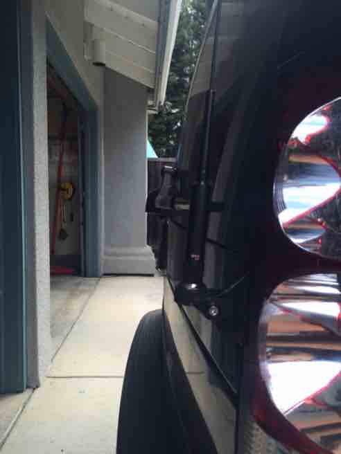

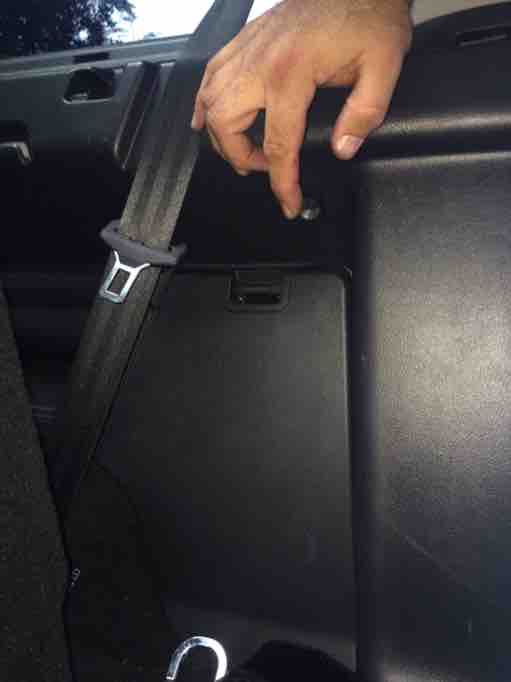

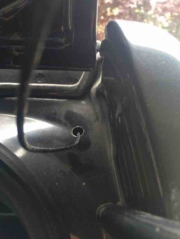

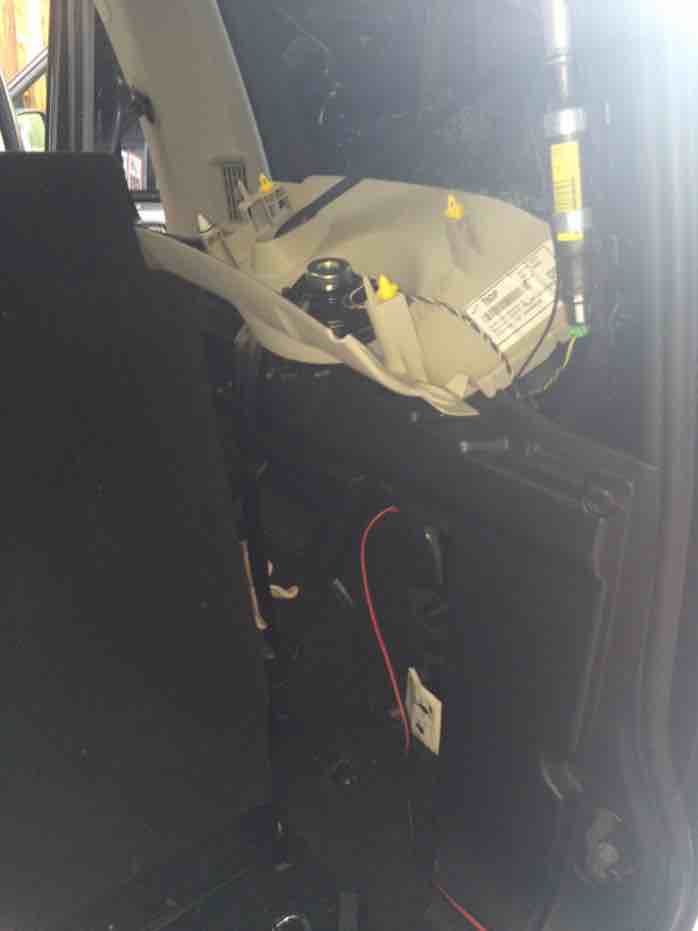

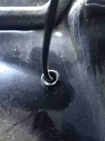

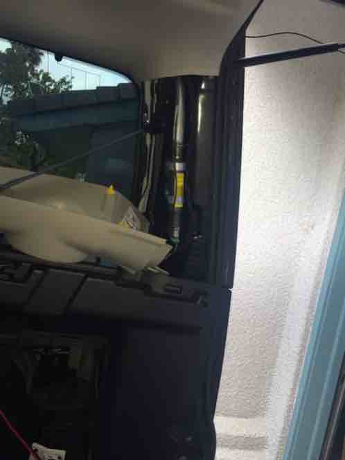

I then drilled [emoji15] a hole in the upper corner of the passenger side behind the lift gate for the antenna wire. I just s club member who has their antenna in the same spot but they ran the antenna cable under the weather strip and crossed over into the car down low and then into the rear trim. I popped the speaker panel off and ran my antenna down to the rear storage where the jack is and then ran both the power wire and antenna cable up to the passenger seat where I drilled a hole to allow for the wires to get to under the seat. ImageUploadedByTapatalk1433997794.960864.jpg grommet and silicone were added.

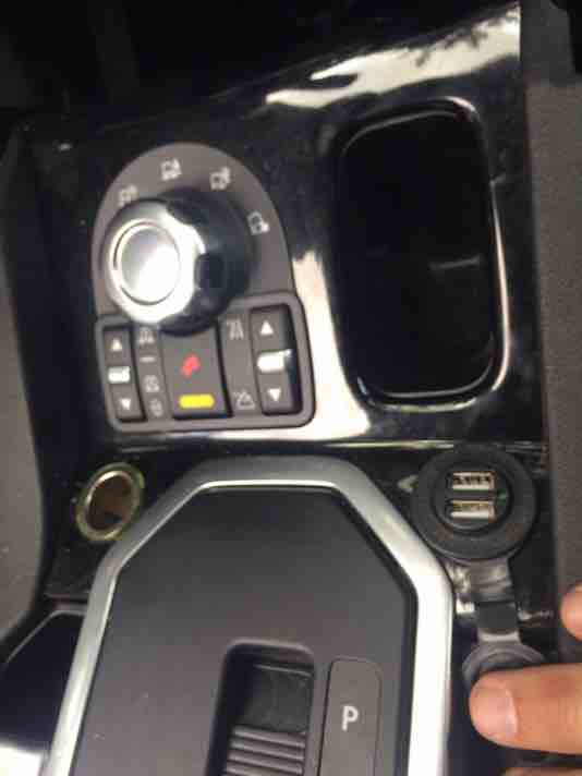

Then I pope off the center console and ran the wire for the faceplate to the front of the passenger side (placing the USB port at this time). I notched the plastic so the cable wouldn't pinch and the HAM brain is in its mount which was modified to make it sit lower as it was rubbing on the seat and I used Scotch double sided tape 20# to hold the radio to the bracket under the seat
