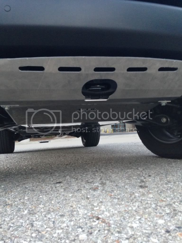

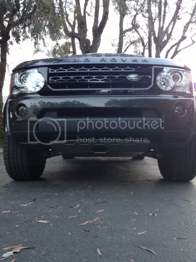

Finally got around to install some of my Asfir skid plates. The front skid plate fits perfectly without any issue but i am having fitment problems with the transmission plate. It hits the exhaust but I plan on getting the truck on a lift to get a better view. I am also waiting to install the rear diff plate. Here are some photos:

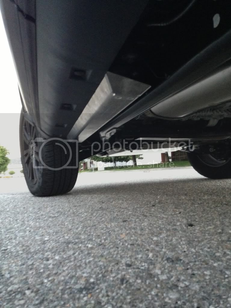

Also installed the air tank plate...you never know! This one went on very easily, a 5min job:

The tranny plate from Tactical 4x4 doesn't fit my 2013 either (without modifications, which they are working on.) According to Eric / Kep, Land Rover added a new exhaust bracket right behind the cats, which wasn't there on earlier model years, and gets in the way of their transmission plate. I am guessing the Asfir plate has got the same issue.
