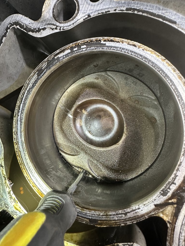

2015 SCV6. Does this look like it's within factory tolerance?

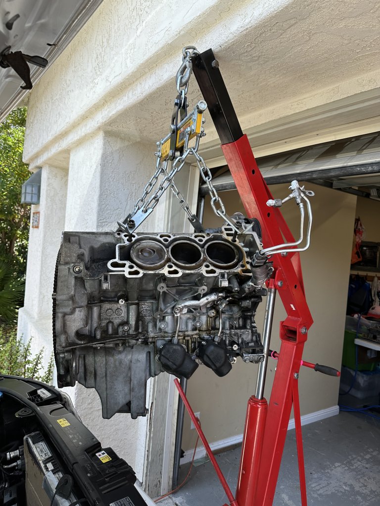

The rest of the internals look great. It was just the one damaged cylinder and bad timing tensioners.How’s do the rest of the engine internals look?
I’ve read a few posts here and there about timing chain issues but most of them are on the V8’s. Most of of us here change oil around 5000-7500 miles so I’m curious.
I believe a timing issue caused detonation in the cylinder. It's now at the machine shop to be resleeved.
Are you implying that this wouldn't happen? Please elaborate if you believe it was caused by something else. I'd love to hear other possibilities.A timing issue that only damages one cylinder that badly?
