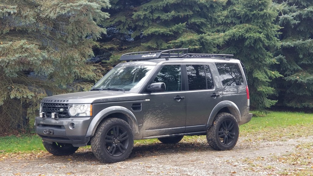

running the 20's with 2.5" lift rods, and 255/50/R20 KO2's

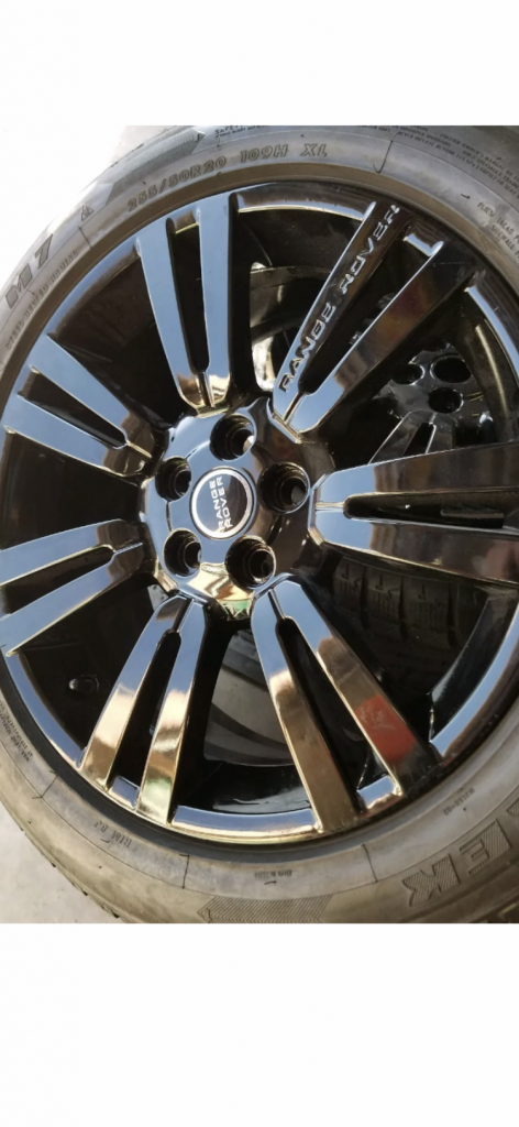

I’m going cross eyed trying to figure out what to do. We have a 2011 LR4 and needing tires bad. I hate the 19” wheel because there like 3 options and I’d like a little more meat.
Thinking about doing a 2.5” Johnson Rod lift and 20’s with 275/55-20 or around that (what’s largest size for 20’s?). Maybe 18’s but the Compo looks like the only option.
So questions is what wheels. I want black and have been looking at powder coated wheels on eBay, but they seem to all be RR wheels. Found these and like them but idk if they’ll work. 50mm offset...
Will 35mm offset work in an aftermarket wheel?!
Help!

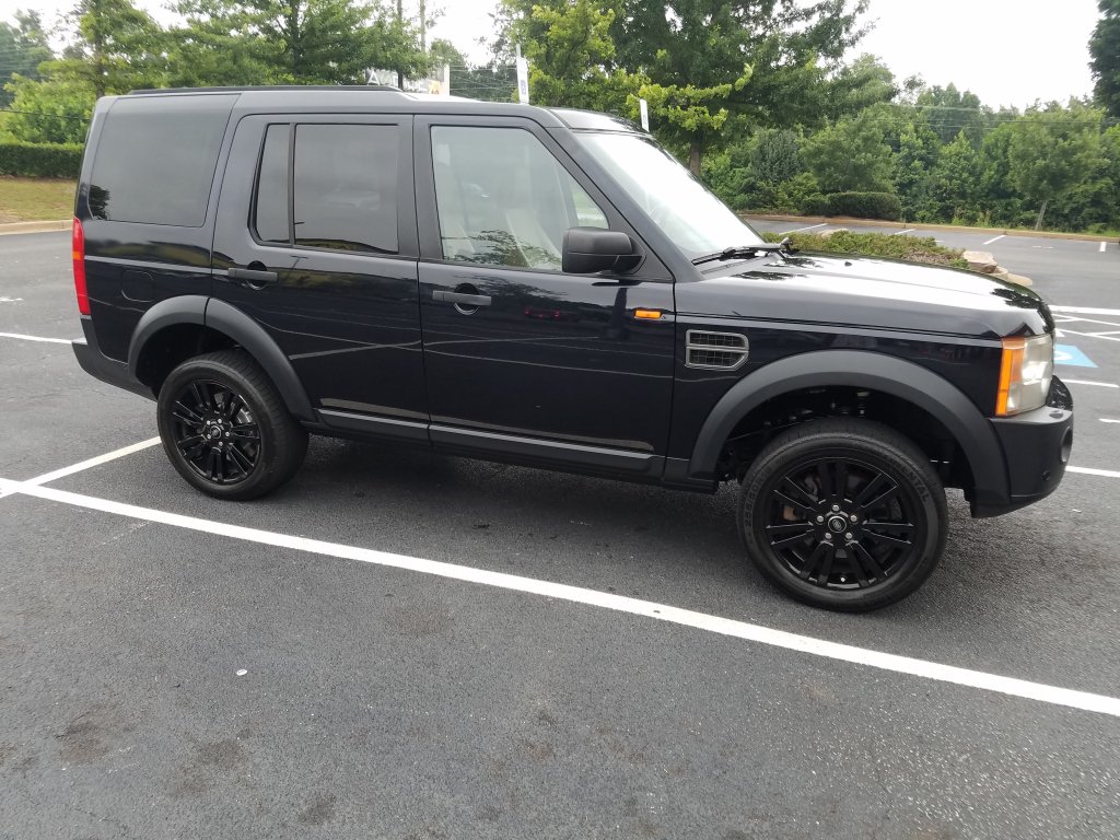

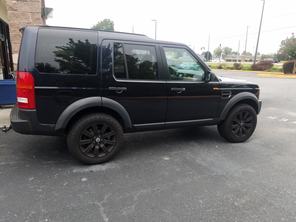

I used some 20" stormer wheels that I found at a great price and had them refinished to matte black. Used with the Pirelli Scorpion All Terrain Plus, 275/55-20 (a newer offroad tire)
I put a pic here of before also, with the 19" black wheels from the LR4 ( I have the LR3)
