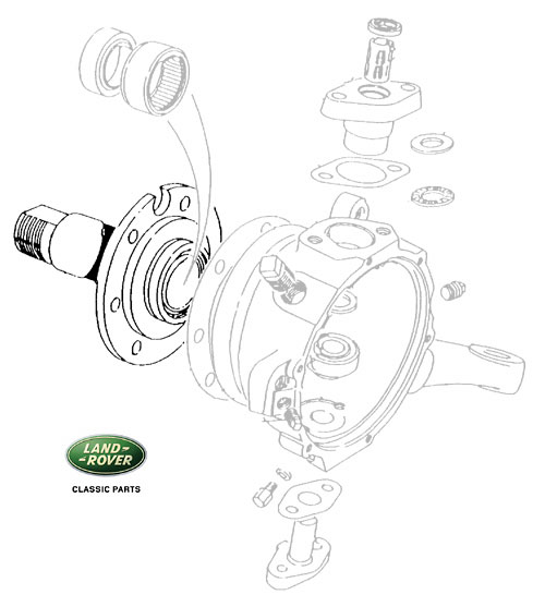

Alloy LR rim with 255/65-70 Michelin tyre weighs in at 58 pounds I recall on the 95 D1. The spare stub housing flange with hub, disc and bearings mounted on a plate, bolted to a 3" square tubing pedestal column allows spinning wheels off the ground. Applying the 1960's era "Shoe" spin balance motor with drive roller able to spin up unloaded wheels hence any slight out of balance condition is detected as well seen shaking even if slightly out of balance. Wheels weighted down, LR app 12 to 1,400 pounds per wheel will smooth out masking or hiding small amounts of out of balance conditions, power steering also hides this condition vs manual steering feedback.The butt-O-meter will detect a 1/4 plus oz. out of balance condition, not what I want.

I haven't a clue what type of hub and disc with double race ball bearing assembly the LR3's and 4's have including how much unsprung weight is involved.
Solid axles on the D1's have a lot of unsprung weight vs independent suspensions able to absorb a little out of balance condition. Solid axles never have to worry about alignment issues and tyre wear, not easy to bang out of alignment. Rock solid last time checked 82K miles ago. Original tie rod ends and rear diff centering upper "A" arm ball joint with still factory stiff joints. Drilled and tapped, installed zerks.
