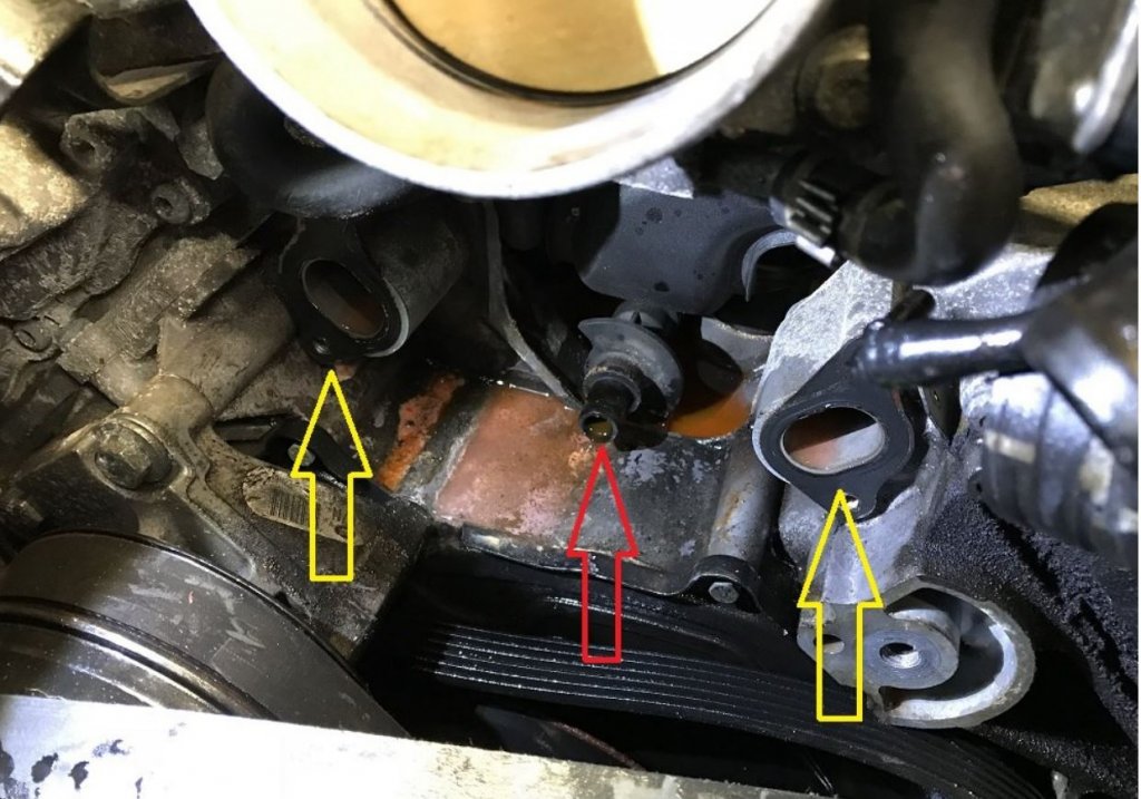

UV penlight and Yellow safety glasses in hand ($15 on Amazon), I find that the Rover LRN2279 coolant already has UV dye in it.
Unlike others, I find nothing UV active except for a zippy tie that I installed myself on an earlier project - and the leak of course....
I find sticky thick red-brown UV active material, that seems to smell of cooked coolant on the flat surface directly below the water pump, (as per the attached photo I shamelessly copy from another forum) so it's either the pump itself or the gaskets.
Additionally, I see a pressure drop from 13 psi to 12 psi in less than 5 minutes.
So it's a grand case of "you might as well" in the near future.
