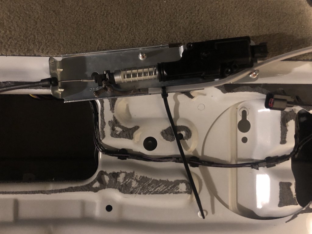

    Yep, I found your thread when searching for an upgrade path. I ended up doing the poor mans version since it’s only to be used in the event of a failure.
    I used some parachord and 1/4 fridge water tubing to make my own. The rope is looped under the L-shaped part of the cable so if it comes off, I should still be able to get it open. Ignore the misaligned trim, the photos were taken during test fitting.

    Most definitely. I’ve replaced it already and can tell a huge difference. It was probably going when I bought it but I didn’t know what it was supposed to be like.
