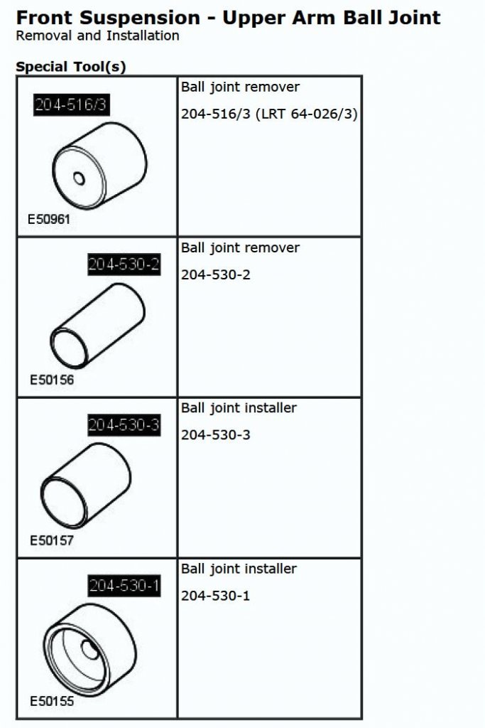

From the manual for the 2016.
I have had good luck on specialty tools by just Googling the part numbers, not sure about these - I leave that to you - good luck.
The instructions are more cryptic than usual, so I assume it's self explanatory once you have the tools in hand.
From the one drawing, it looks like a bearing press kind of operation - might be able to just use standard bearing press rings.
