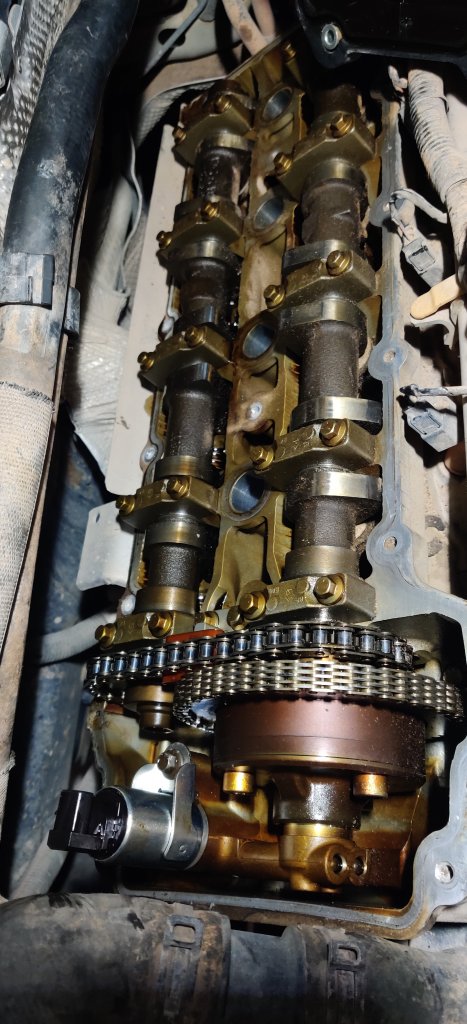

proslambanomenos
Apr 21, 2013
46
Did this job last night. Nothing incredibly difficult, just somewhat time consuming. The solenoid looked clean so it must have just failed. I swapped it out and I did replace the gasket and plug o rings with new and used a little gasket maker in the two spots indicated in the manual. I also replaced the solenoid gasket/o ring. I haven't driven it yet (will give the gasket maker a day to cure properly) but I did start the engine and already the codes were cleared.
