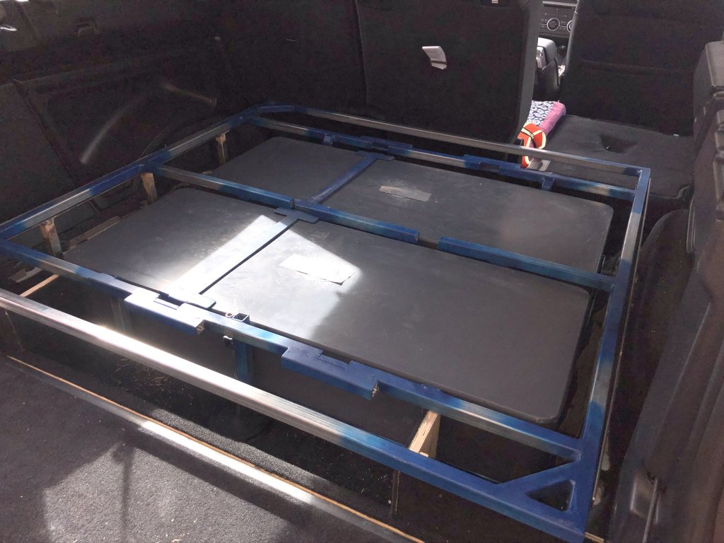

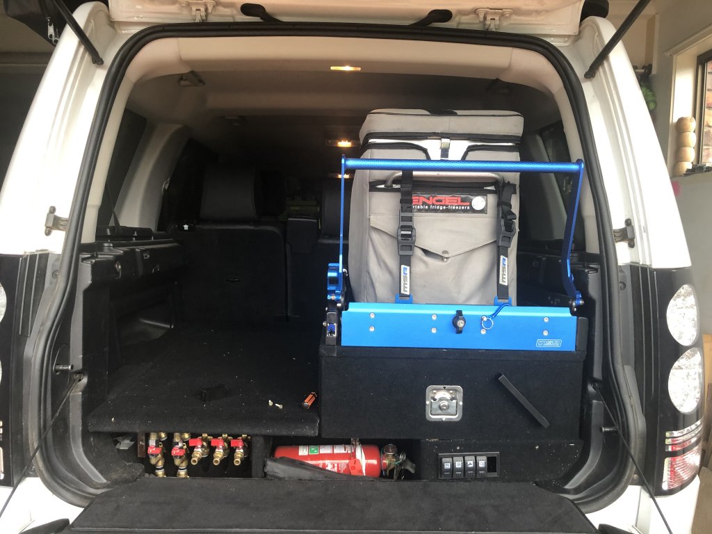

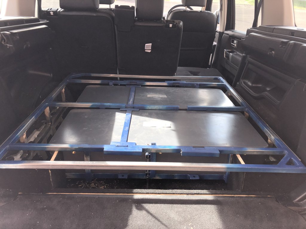

    G’Day All - hot, dusty Aussie here
    Not 100% finished yet but I have mounted 2 x 40L tanks in the rear of my D4 after removing the back seats - whole system bolts into the existing seat mountings and it only raised the floor level by about 100mm. Real low close to centre of gravity.
