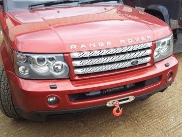

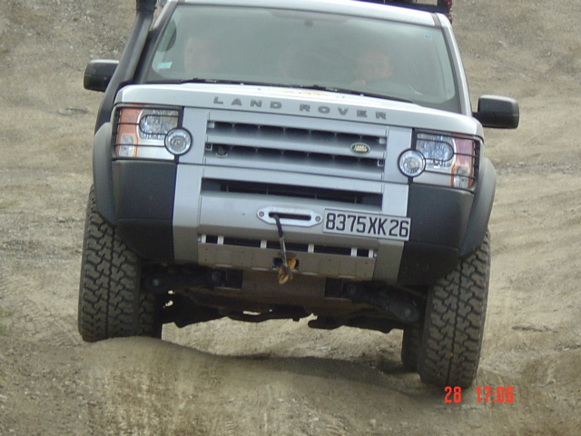

Hello guys,
So I'm interested in getting a winch for the LR4.
But id like the set up to be clean, I've seen some LRs and RR's with winches built into their bumpers(please see pics)
I know some, actually got a custom off road bumper.
i want to go for the option where the winch gets installed behind the stock bumper and a slit is made in the stock bumper? Any suggestions? is this possible?
Please see pics

Definitely possible, as the LR4 is nearly the same as the LR3 as far as clearances behind the bumper are concerned. There is actually a recent thread on ExPo of someone installing a hidden winch behind a stock LR4 bumper, it's very well documented and a good point of reference should you wish to DIY: http://www.expeditionportal.com/forum/threads/159115-LR4-Hidden-Winch-HF-DIY-Install
You may need to be an ExPo member to see photos in that thread, not sure.
Bama4door
Sep 4, 2014
69
Thanks for the kind words Umberto, that's my thread I started on ExPo. I would say with the hidden winch, it's all dependent on how much you want to spend. There are a few companies that make winch plates for the LR3/4 for around $600-$1000, plus the price of the winch. Or you can go the route I took and just make something of your own in a way for a lot cheaper.
I can throw up some pictures on here if you can't see the pics on the thread Umberto posted, just let me know.
