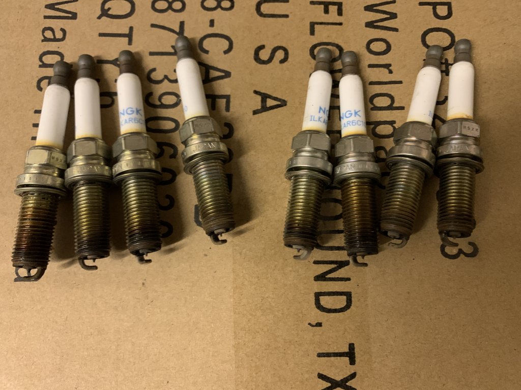

good words! I’m a little more than 1/2 way through the job. Passenger side has plugs out, injectors removed and new injectors in place (did before removing plugs as to not get any debris inside the fuel system). I was actually really surprised at how smoothly it went on that side.
on the drivers side I’ve got the plugs out (as I was curious how all the plugs looked and was having much more trouble pulling that side fuel rail). All plugs look pretty good for 133k on them. Some have more carbon than others, but does not look like a case of fouled plugs or bad fuel.
I don’t want to jinx myself so I’m holding off on claiming victory here. Wish me luck! Will report back when job is complete. I am traveling this week so it won’t be til Friday.
