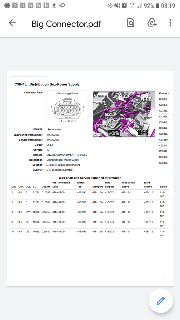

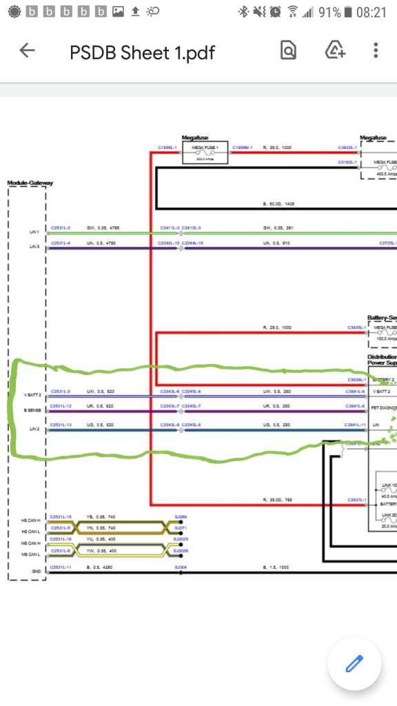

The install and integration of the kit is perfect and did not cause the ECO light. My removal of the start / stop components is the cause of the light.
Specifically, it is the removal of this plug:
This plug communicates with the gateway module through VBATT2, B Sense, and LIN inputs from the power supply distribution box. I tried attaching a 12v jumper to VBATT2, but ignored the other two inputs.
I am just trying to figure out how to "trick" the truck into turning the light off lol. Otherwise, it's illumination does not cause any ill effects to driveability.
Just to reiterate, there is nothing wrong with the kit! It's my favorite purchase to date.
