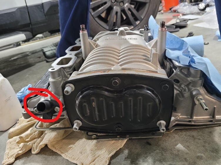

I didn't end up changing the supercharger oil after all; next time. Have replaced the lower crossover pipe, rear crossover pipe, water pump, serpentine belt, thermostat, PCV valve. Reinstalled supercharger but I can't seem to figure out from my progress photos, what was attached to this port at the rear passenger side of the supercharger - anyone help me out?
I just went through all of my pictures. I don't remember it attached to anything; and, in the pics with the sc removed, there was nothing to attach to it. If I remember correctly, it's completely blocked off.
