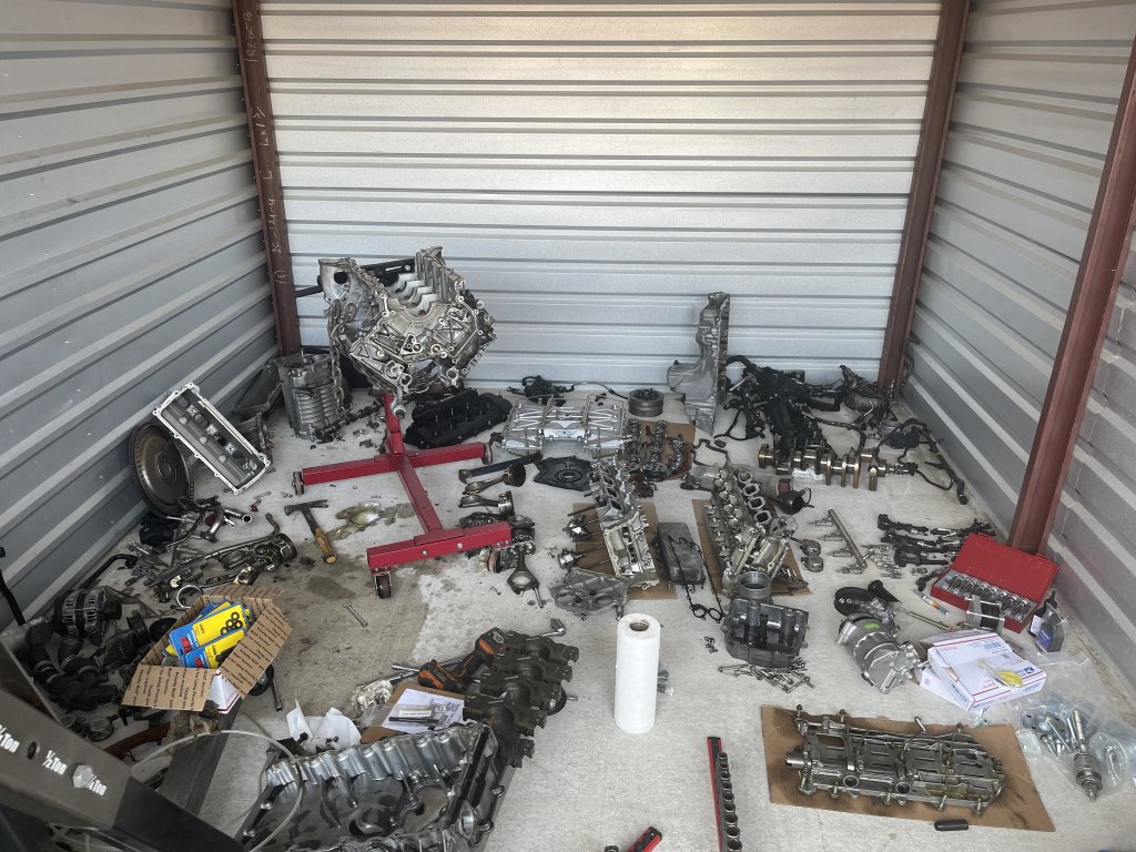

Well, I'm finally getting off my rear and making some progress. I've been playing with my SDD tool and thankfully, the company I purchased from is going to team viewer in and program the used ECU. Fingers crossed it works!
Also, finally got the block all torn down and it's headed to the machine shop!! (I should add, this is the point where my friends/parents come look and say, "That thing is never gonna run again! What have you done?!?!?").

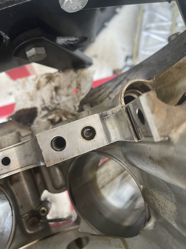

Unfortunately though, I had a main cap shoulder bolt snap off.... Hopefully the machine shop can extract it....without messing up the aluminum block.
Fingers crossed when the machining is done, everything is within spec! I'm a little worried about the #2 cylinder as it looks like the spun bearing provided a little too much play and the bottom of the cylinder looks like it may be worn....time will tell.

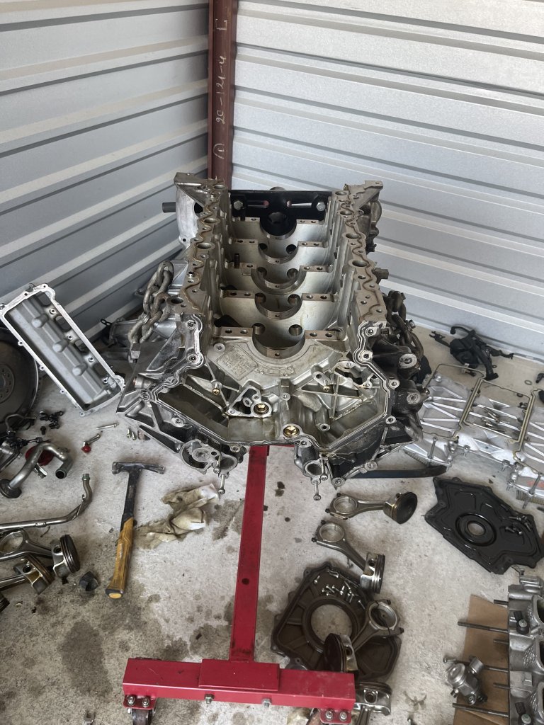

Also, you can kinda see in the above picture the oil squirter on the inside of the block. As I understand it, the presence of the oil squirters is the only difference between the NA and SC blocks....but it's a big one! (I'll take a better picture today when I take it to the machine shop.)
