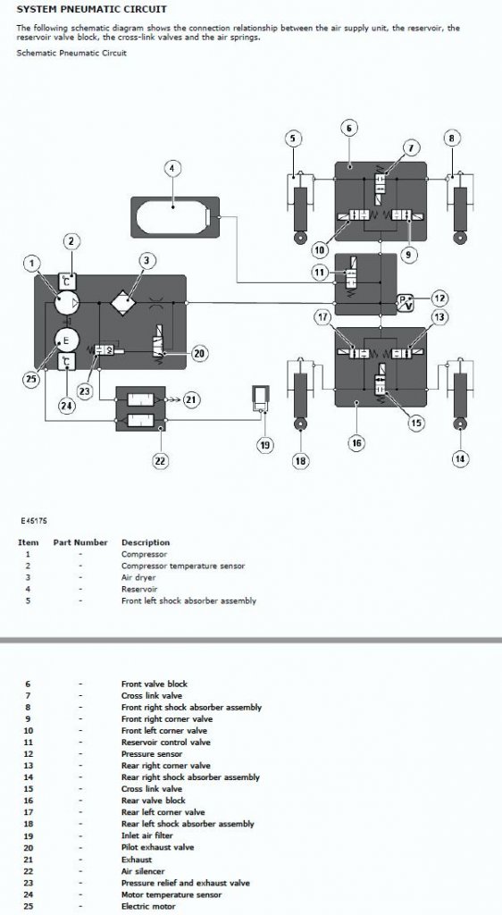

I find the observation that all 4 corners come down simultaneously to be really interesting. That tells me it needs to be in the "common" bit of the system because what are the odds of a simultaneous failure at all 4 corners - even if it IS a Rover...

The only option that addresses all 4 corners simultaneously would be "exhaust valve stuck open".
That means that each individual corner valve must need a fully pressurized system or they backflow, and when they backflow the corner would come down. And they would each backflow at slightly different rates.
You said you have the mechanics manual, but for those that do not, here is the pneumatics diagram (2014-2016)
Wow, so that would hint that if the gallery pressure drops, the four corners are not as isolated as assumed.... Which would lend itself to the thought that if the reservoir valve, or a rear gallery line I haven't replaced is cracked/failed, that could cause everything....but still, with fuse 3 pulled, the air suspension module shouldn't be trying to level the vehicle. Unless I'm dealing with deeper electronic issues such as power bleeding over from somewhere....but I'm not ready to start down that path yet. Or it means the system isn't 100% airtight and there is some bleed through even just sitting there. Although that makes no sense and is counter to everything I know about the system.

The exhaust valve stuck open doesn't guarantee the vehicle will fall, once the springs are pressurized to reach the desired ride height each individual air spring is then isolated from the gallery (per a valve for each corner, 9/10/13/17 in your image). If each valve had a small leak but nothing else was leaking the vehicle would only fall a tiny amount but you would expect to see the gallery pressure go up... Another crazy idea (that's all I have at the moment! and I know the OP has replaced almost everything), there's a leak at the front and a different one at the rear, doesn't the computer monitor while the vehicle is off and open the cross link valve 2hrs after ignition off and then 6hrs thereafter?
This would cause the vehicle to slowly lower, so for example, the front left spring or pipe has a slow leak so that side goes down but the right side stays relatively still; after 2hrs the cross valve opens to equalize the pressure and so the right front falls a little (and in theory the left front would go up a little (as the pressure would go up a little)). At six hours after ignition off, the front left would have fallen some more but the front right would stay at the +2hr height; then the cross valve opens again and we once again see a height equalization and so on! Rinse and repeat at the rear!

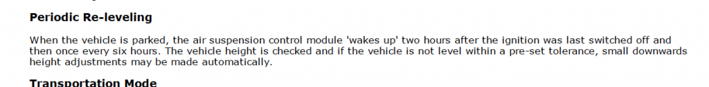

I don't believe it opens the cross valve....although I could be wrong. If I read the manual correctly, it makes small downward adjustments to "level" the vehicle. This would indicate it exhausts the higher side valve to bring it down in line with the "leaking" side. Which again goes back to the fact that all 4 corners are independent and shouldn't move once inflated and there's no power to the Air Suspension module....hence why this is SO FRUSTRATING!
(For those who don't have the manual)
I think we're both assuming... It doesn't say which valve it opens and to be honest I don't know! By opening the valve on an individual corner you would also have to open the exhaust valve at the same time (to vent the pressure). In this scenario you're "throwing" away good air pressure. Opening the cross valve just equalizes the pressure across the axle and is much simpler! Like I say, I don't know and I'm also down in the weeds with my idea/suggestion!
"Wow, so that would hint that if the gallery pressure drops, the four corners are not as isolated as assumed...."
They have to be isolated, here's why!... If you raise the vehicle the first thing that happens is the middle valve is opened and the air from the reservoir raises the gallery pressure; at the same time the compressor comes on and the four corner valves are opened until the desired height is reached (meaning the pressure in the springs and gallery is equalized and is much higher than the normal operating PSI of the gallery). When the desired height is reached the four corner suspension valves are shut but the compressor continues to run meaning that the gallery and reservoir pressure continue to go up in readiness for a possible height change (it's a mechanical capacitor at the end of the day - it stores energy). Once the correct reservoir pressure is reached (on mine it was 258psi) the middle valve closes, the compressor shuts off and the exhaust valve dumps the gallery pressure down to 20 - 40psi range. Here's the reason there's isolation, 20 - 40psi in the airsprings would be insufficient to suspend the vehicle; if you were to equalize the four airsprings to the same pressure as the gallery you'd be on the bump stops. I figured this based on watching the valves open and close when requesting height changes. I think the gallery pressure is lowered to take stress out of the system; the volume of air in the gallery is relatively low in comparison to the reservoir and airsprings so dumping has little impact on the system...
