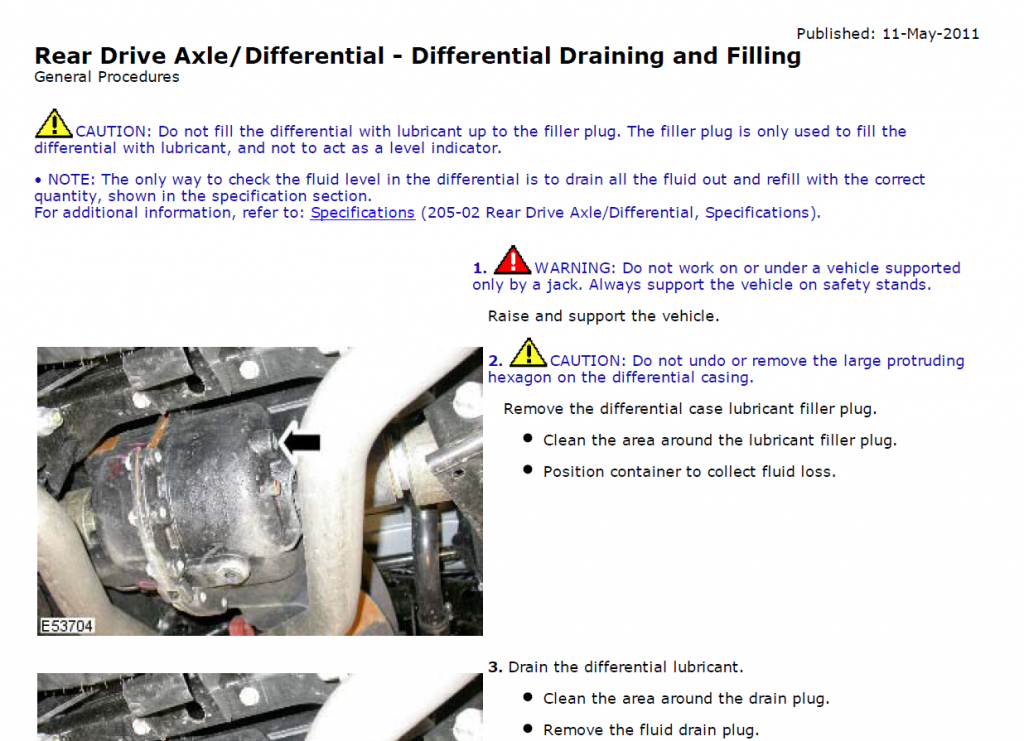

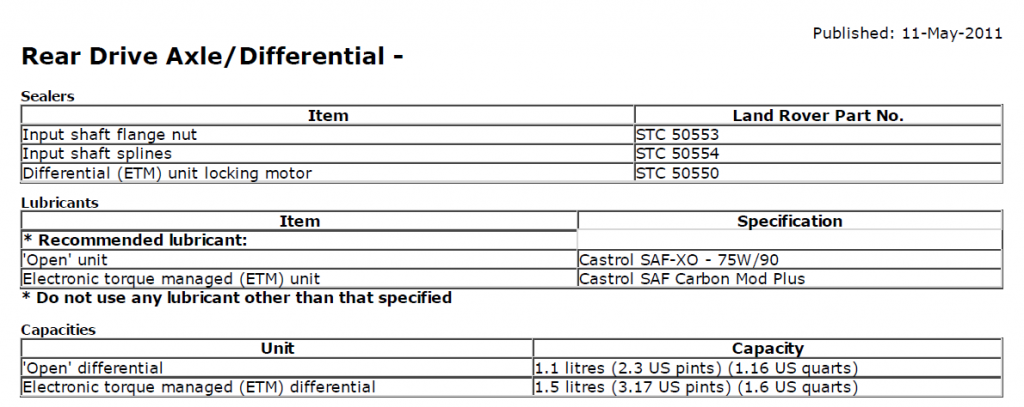

I have no idea what bandwidth this guy has on his file share, but this is one of the only complete workshop manuals I've seen online...
http://www.mediafire.com/file/a9strl6pfp4vvzf/D4_Workshop_Manual.pdf
Page 540/5528 covers this.

Genuine Differential Fluid: Rear Electronic Locking Differential 1 Liter Castrol Bot 720 2 $95.90
Differential / Axle Oil 75W90R GL5 Fluid 1 Quart 2 $43.90

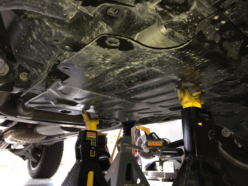

The front diff is the biggest pain the ass compared to the others because you need to take the front skid plate off.
The drain hole is front and center once the plate is removed.

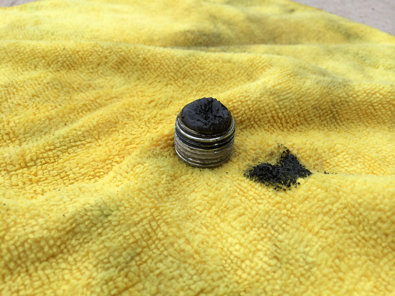

I found the same gunk on the front drain plug.
To get the best access to the fill hole I removed the drivers front wheel. It made it much easier to fill the diff.
It took just under 1 litter.
