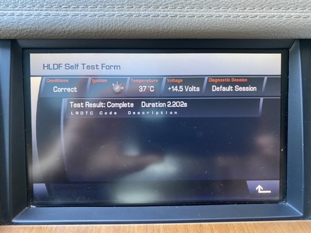

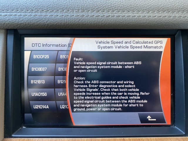

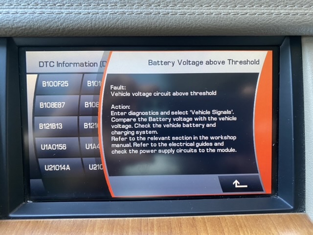

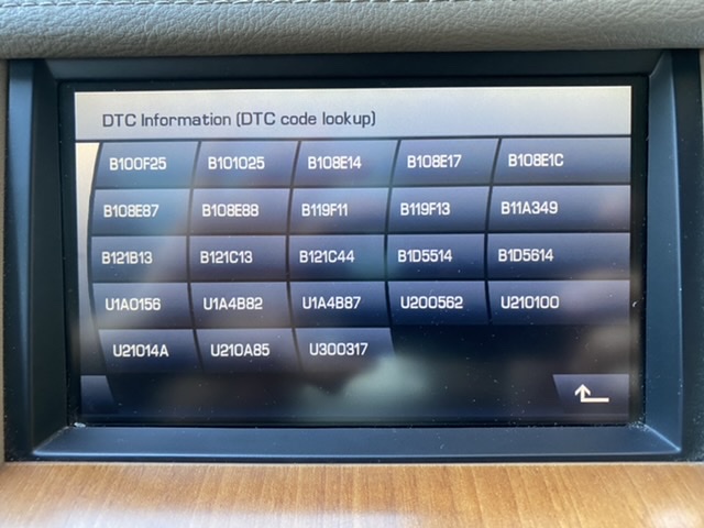

The hidden diagnostic menu shows a bunch of DTC codes. Mostly seem to be related to the infotainment system, but there are couple of interesting ones related to vehicle speed signal and high battery voltage.
(see images below)
Anyone experienced these issues?

How old is your battery? These trucks can be very sensitive to low batteries which can cause it to throw all sorts of codes. I would start there and hopefully that solves your issues.

In my experienced as service technician of the other lines of vehicles . Over charging or under charging alternator will cause multiple issues . It will throw the power train control module intro a frenzy thus causing erratic idle issues and it will give you multiple erroneous fault codes .

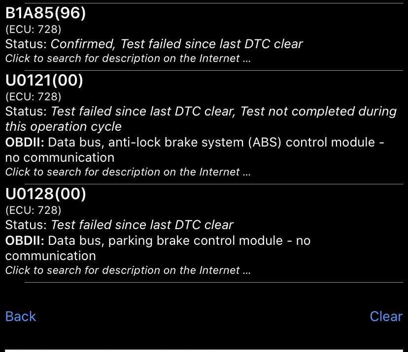

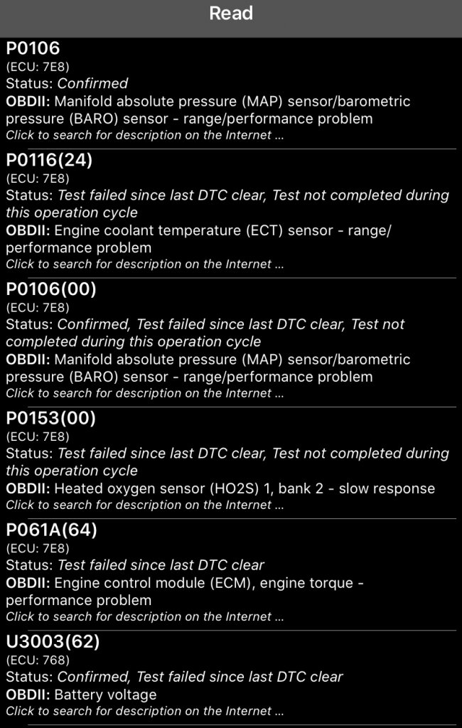

I ran a cheap OBD-II scanner which detected some error codes (see images). I was able to clear all of them using a free app I connected to the scanner through Bluetooth. After running the vehicle for a week - no issues show up when I ran the scan again. It seems most of the issues were one off / old codes that have been resolved. Some could have been related to the water pump failure and coolant leak few months ago.
