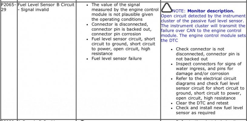

I am researching, and wanted to post here to see if anyone has seen/experienced this code. I did not find anything when searching this forum. I'll post as soon as I get more info.
I did clear to see if it returns. BTW, it's "Historic" so may not still apply, or return, but would still like to know potential issue.

This would be related to the fuel level sensor in the tank. Closest thing I could find is code P0265. See attached.
