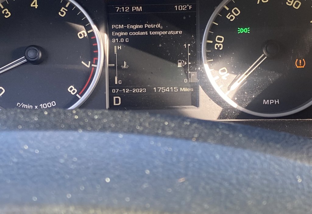

I noticed coolant temps are running 5-10 degrees more than normal if I sit for a couple of minutes in Drive (stoplights) blasting the AC.
Driving temps stay the same.
Temps only rise when stopped and in Drive w AC on. If I put it in park and rev over 1,000 rpm the temps go down.
If I run with the AC off, the temps don’t rise above normal.

Makes sense, especially in TX -- the 5.0 (and 3.0 for that matter) utilize an egnine-driven viscous fan rather than a separate electric one. If you shift into P or N when its hot you'll see the car up the idle speed to ~1050 or so RPM to speed up the cooling fan. But nothing it can do when you're in D and idling at 650 (or whatever). You'll probably notice the A/C isn't quite as cool when stopped, either.

Can confirm that the coolant temp stays 91c and below during my morning commute. Same commute. Same stoplights. I guess it loses some efficiency in the extreme heat.
This morning it’s only 88f and functioning normally with AC on blast.
AC temp is also cooler
