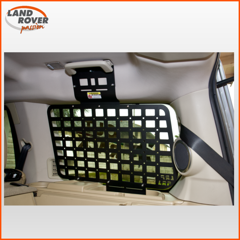

Hey. Looking for a molle panel as well. Unfortunately my “friends” are all the Yota folk and they seem to have endless vendors supplying all manner of accessories. Much tougher for us. I really like the molle rear window panels in the cargo area they get but doesn’t appear such a creature exists for the Disco.

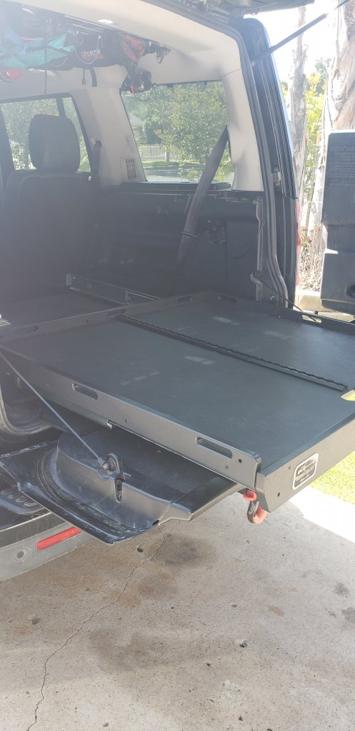

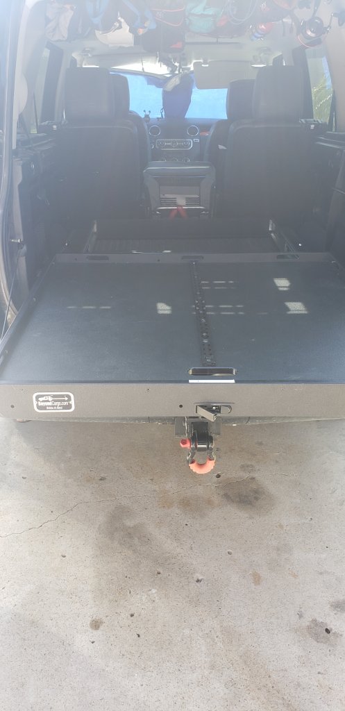

Thanks to @Fuji4, I now have this beauty!

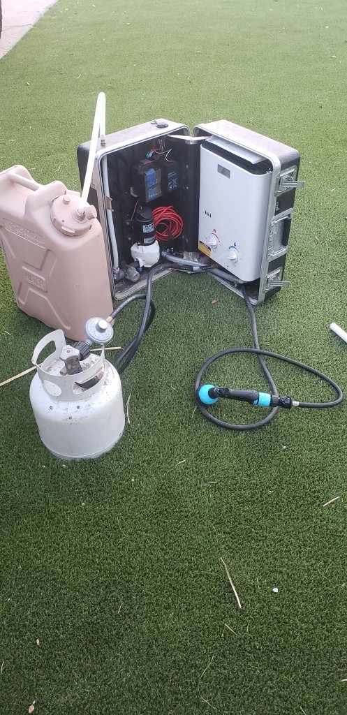

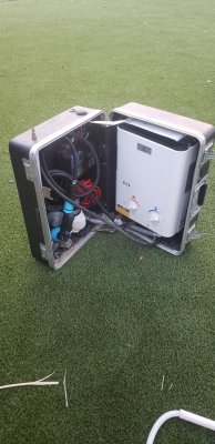

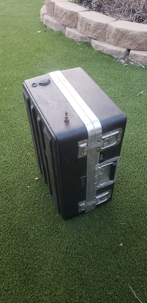

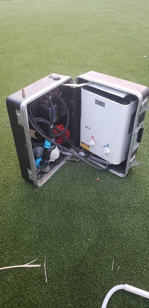

I guess I should put this into my gear collection too. I made this a few years ago and it's still running strong. It's my hot water system that allows me to connect to any water source (my 5 gallon mil spec water tanks), propane (baby 1 gallon/5 lbs), EcoTemp L5 water heater, Shurflo self-priming water pump, and 12v built-in agm power or cigarette lighter socket.
