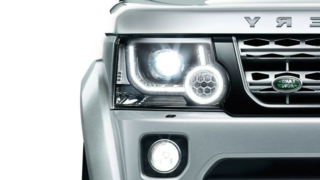

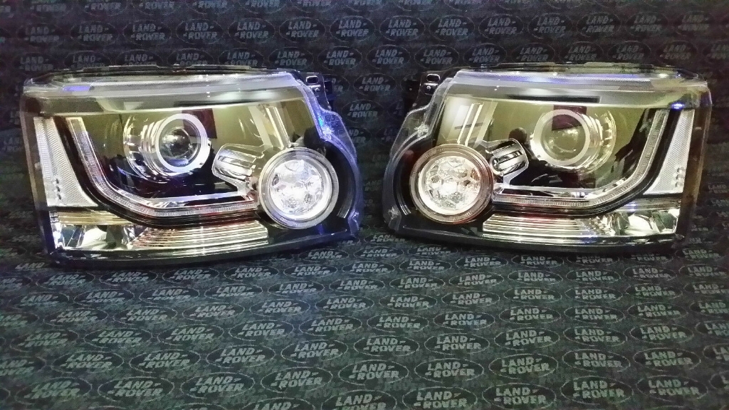

So, to hijack @iconoclast 's thread a little, I just want to thank him for the idea of sourcing e-code headlights. For those curious, he gave the part numbers for the non-adaptive e-code headlights in this post here: https://www.landroverworld.org/thre...an-lr4-with-halogens.30832/page-3#post-191477
I got too close with a power washer on my 2012's front grille last summer and delaminated some of the clearcoat off of the plastic. Of course, I can't do anything without researching myself to death and spending too much money, so, rather than ordering the same '13-or-older grille that I had (or even just spraying some new clearcoat on the one I had), I ordered a grille for a '14-to-newer LR4 and got some new e-code '14-to-newer headlights to match.
As this video demonstrates, if you have both the grille and the headlights, it can fit:
You just have a little gap underneath them if you do not also replace your bumper with a '14-or-later bumper. I have no interest in doing that, so I also ordered the little gap filler piece that Powerful UK sells.
My LR4 is black and I ordered an all-black grille, so I can't really even notice the gap underneath it. I'll probably still install that filler piece, but only because I have it.
As you stated, @iconoclast, the beam pattern on the e-code headlights is top-notch. The only issue I had (and probably because the headlight housings were new) was that I had to aim the beam pattern. As I received them, the cut-off was aimed way too high. As always, I used Daniel Stern's guide to aiming headlights: http://www.danielsternlighting.com/tech/aim/aim.html
I believe this culminates my headlight journey in my LR4, both because this is the best it's been and because there's no place else to go.

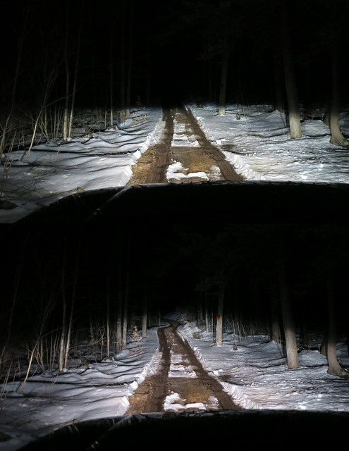

The "Valeo" brand euro spec housings came with Phillips xenon bulbs. I imagine just standard ones. Phillips or Osram are considered the best, but these particular Phillips bulbs are not on the bright side. This summer in the pitch black of Colorado mountain passes I felt like the light was a bit dimmer than I would like.
So, last week I ordered these: https://www.amazon.com/dp/B07FY78JBQ?psc=1&ref=ppx_yo2ov_dt_b_product_details
The Osram Xenarc Night Breaker Laser D3S, which is a ridiculous name. But they are supposed to have substantially more output than a standard xenon bulb.
I'm normally pretty wary of headlight bulb promotional language like this, because it's often not true. But the claims on these check out. Here is a comparison review:
I put mine in this evening and can tell a pretty big difference.
