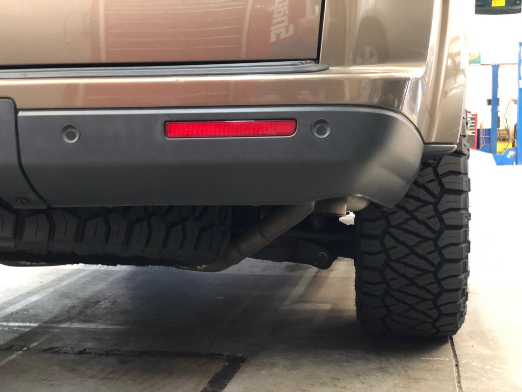

Just to add one more detail to the mix. I figured someone might be interested in how the spare fit. As I mentioned, it is aired down and the heat shield/valance piece removed.
Regardless of that one detail, I'm not sure I've ever gotten quite so excited about a set of tires and rims.
Another thing worth mentioning. The guy at Discount Tire that did the install didn't think they were going to fit until he tightened the lugs. The caliper touched slightly until he did that and as others have mentioned, there's just the tiniest amount of room (he said credit card width) between the caliper and rim.

just grind off about 2mm at the two tight spots on the caliper i did more when i was making 17's fit with spacers.
looks great
