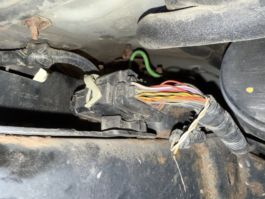

The 48 pin connector is there. Since your vehicle didn't have the e-diff. the connector is blank.
The e-diff connector would plug right in.

Is this the connector you’re referring to or are you saying there should be a separate connector for the differential. I can see where there is a spot for another connector on the plastic mounting surface beside the big connector pictured here

I have the carrier and axles installed. Is there anyone that could verify the 48 pin connector is wired coming out of the interior into the connector?

I was able to get the wires from the diff and temp sensor pinned into the 48 pin connector. Using the gap tool I was able to turn on the diff and update the ccf. I now how a working fully functional retrofit locking rear diff
