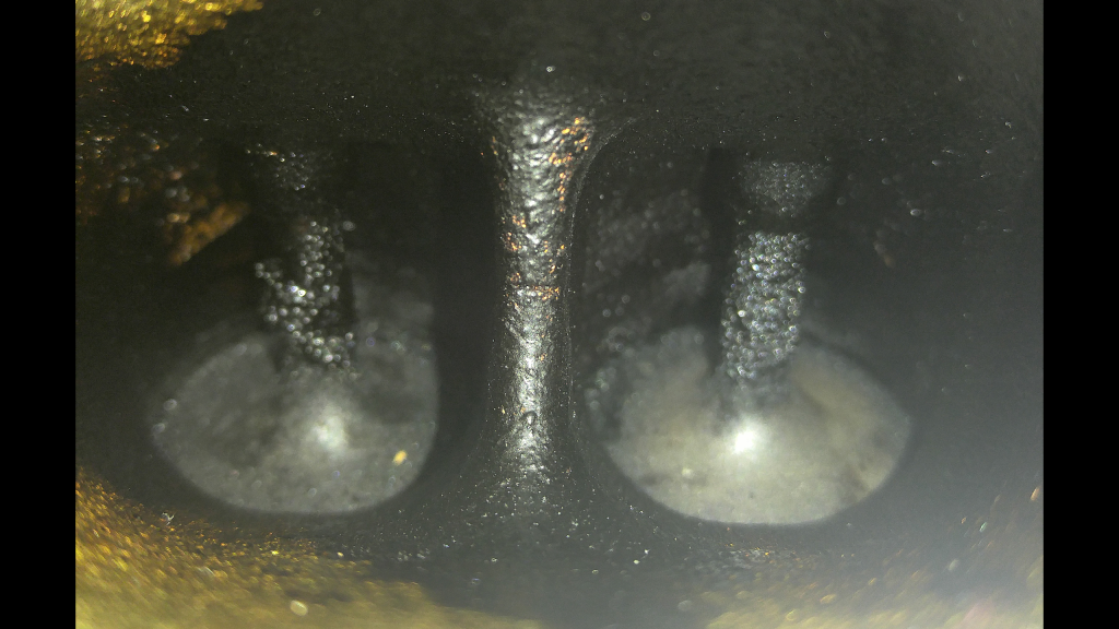

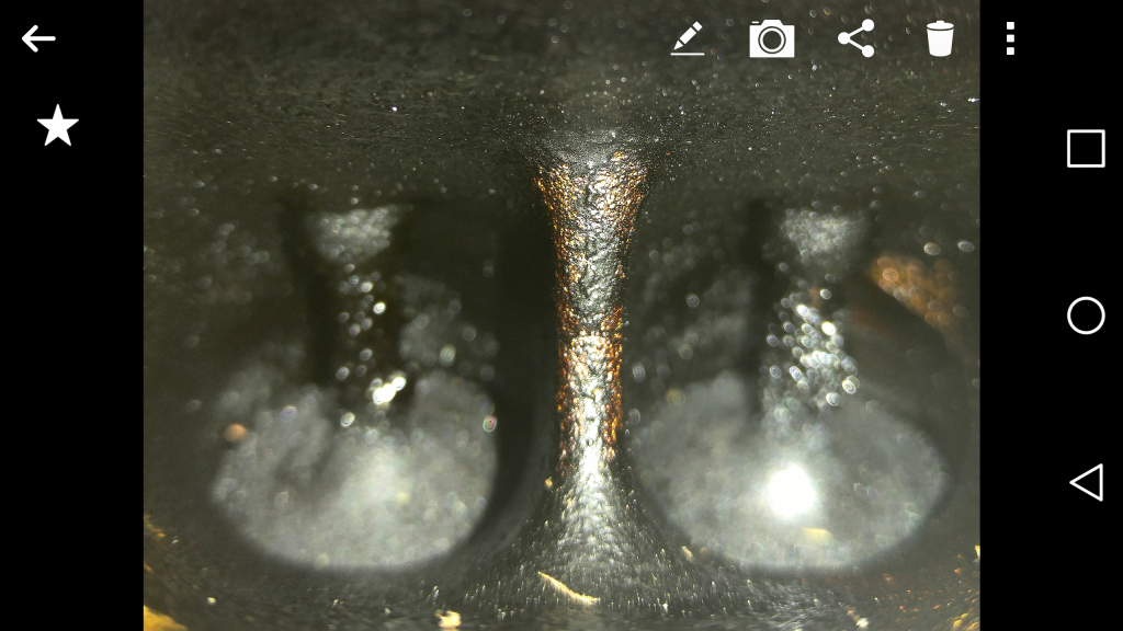

Do you have pictures? I don't know of any other fixes other than having them 'walnut shell blasted' or whatever a machine shop would do to fix them. Valve cleaner and careful elbow grease is probably fine.

this was from back in September when I had manifold off. I got most of the build up out. No codes or performance issues just want to prevent problems.
