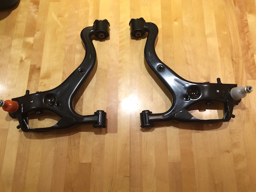

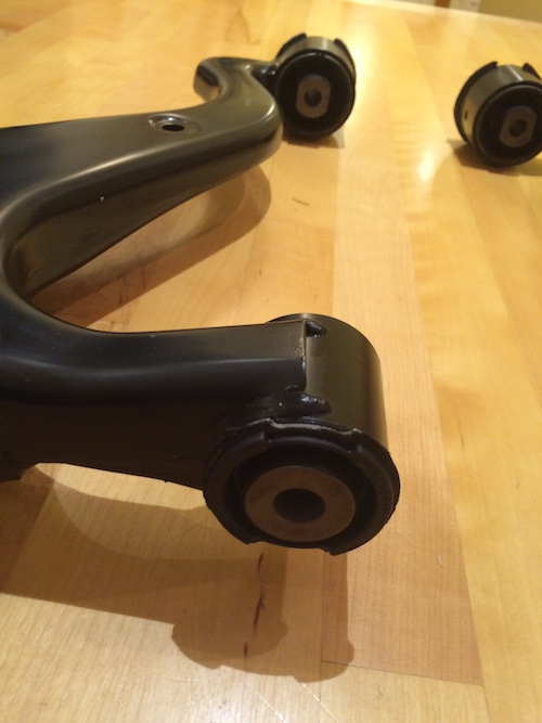

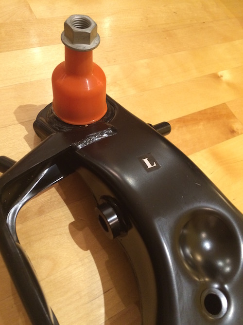

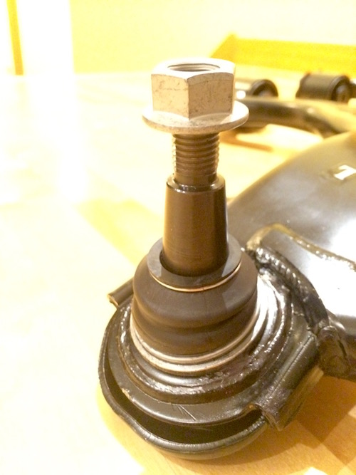

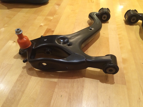

Control arms arrived today. Well packed and as expected. Pics attached.

Which ones did you get? RR Sports? Lr3? How much did you pay for them? Thanks.
