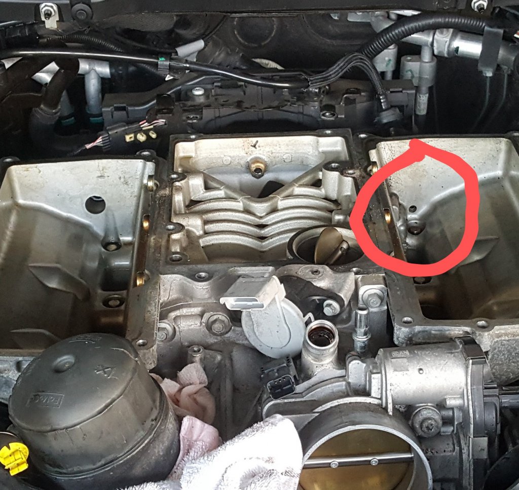

Thanks again for answering this. The one up front is pretty easy to get at but for the life of me I can't find the MAP sensor on the back of the intake manifold or if its the exact same as the other sensor or an entirely different part.
Part numbers given in the other thread.
In red, I circled the hole where the MAP sensor mounts. Feel around between the firewall and this location.
The MAP sensor on the back for the scv6 engines is the connector that’s a pita to remove.
Absolutely agree. I found it easier to remove the bolt, pull the sensor and harness above the intercooler to remove the connector.
