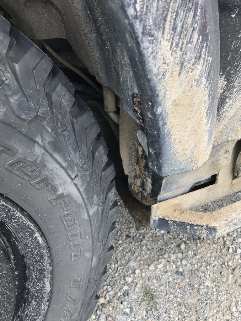

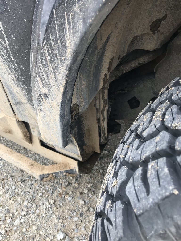

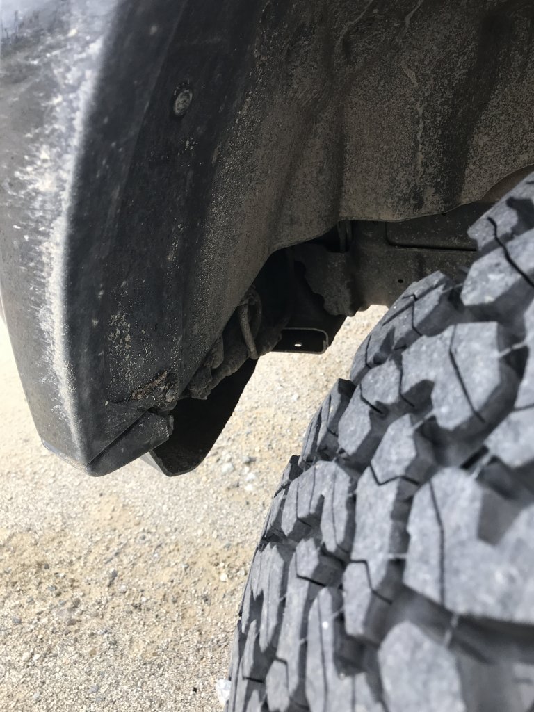

I’m interested in feedback following install/mods...I have 275/65r18 (32.1”) KO2s, along with strut spacers, wheel spacers, and lift rods and I had to do a good amount of cutting of my sliders and frame (horns) and plastic in both front wheel wells. Ask the shop if they do any cutting as most mechanics won’t, usually just off road shops. You can also reshape the plastic with heat gun. Haven’t read comments but I’m sure there’s a lot of insight recommendations to help you be more aware of potential future issues in order to monitor during maintenance and on trips.
My next tires will be more narrow, but still want more sidewall for trails. Not one regret with bigger tires and lift, already come in useful on many a gnarly trails Would have liked to record process but when I installed had tight timeline due to departing on trip next day...worked till 4am in garage with wifeys help. She doesn’t let me forget. Haha. Good luck
1-you (we) don't have actual 32" BFG ko2 tires. BFG run small and are more like ~31.7 at best. Compared to my Michelin MS2 set of same numerical numbers which is an actual 32.1 or so.
2-I also have spacers on this set (mine are 25mm) but the 33.7" 285/70-18 bfg km2 don't work with the spacers on. They grind into all sorts of **** and that's even with having an ARB front bumper plus all the mods and refined them more than normal.
