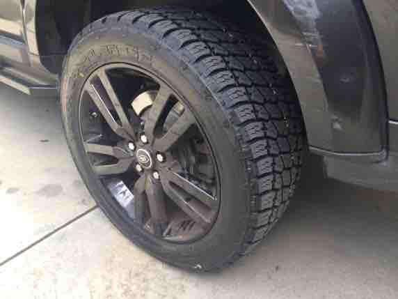

I just went through this. We went w the Nitto Terra Grapplers G2. It was about $1038 out the door for 4 with road hazard on each for 4 tires. The look pretty good for an AT, are surprisingly quiet on the road. I have a week long expedition through Oregon coming up soon and will get to test them off road. So far I'm very happy with them. View attachment 5377

I have the green oval 3 way rods (stock, lifted, emergency extra lift settings. You have to manually switch them but it only takes a few minutes). This allows my wife to drive around as stock (it is her DD) and then lift when we hit the trails. We went with the 255/50/20's as they don't run at stock height. I'm really happy with the G2's. 65,000/6year tread warranty. Quiet and have done very well off road.
