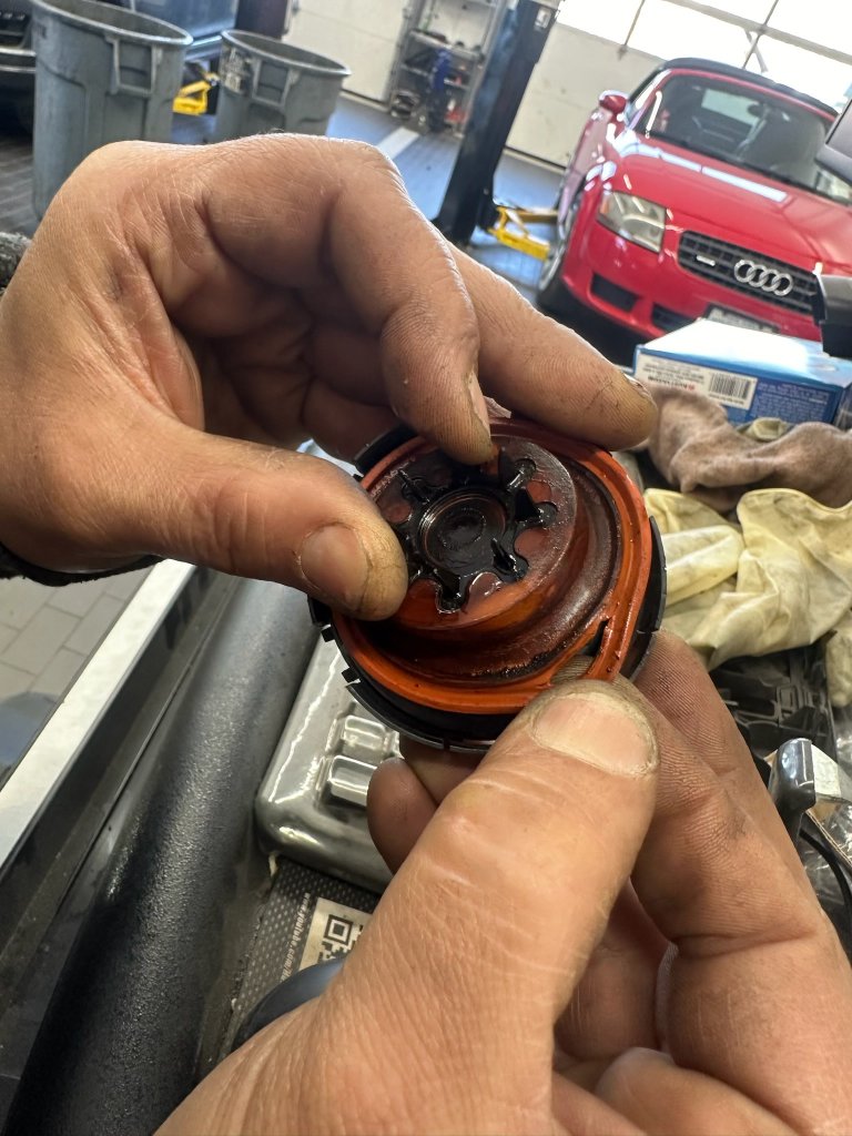

hopefully not into the intake, like my car.
ttforcefed
Dec 19, 2010
675
215
I did have oil leaking out when I pulled the intake manifold. What was the resolution in your case?
Vacuum pump replacement and this:
