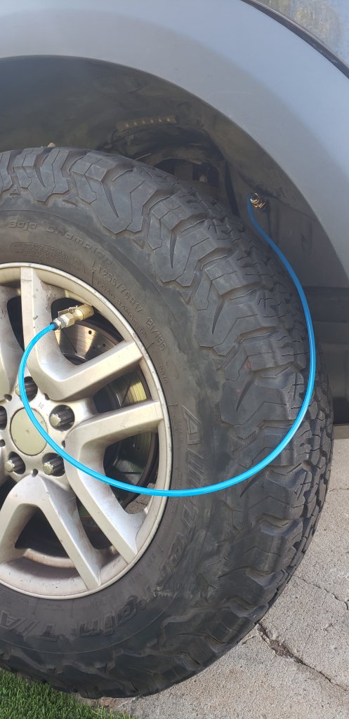

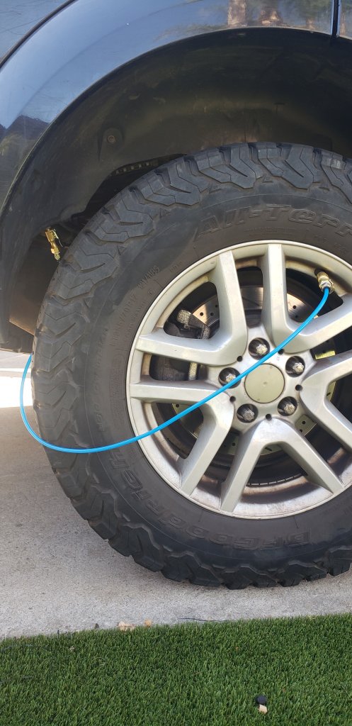

As you can see the front and rear sidewalls get used up pretty well. I use this setup for almost every terrain.
On everyday pavement I run 40 psi up front and 45 in the rear. Oem is F38 and R42, I just rounded it up. Btw... tire shops recommend oem psi for any tires mounted.

@djkaosone I have some rules of thumb for how much to air down offroad from street pressure, but the recommendations for that street pressure vary a lot. I've had limited success with the chalk technique before, but I might have to try it again. Another one that used to be recommended was that you wanted a credit card to just barely be able to wedge under the blocks at the edges when parked on concrete.
Nice air-up setup, BTW!
