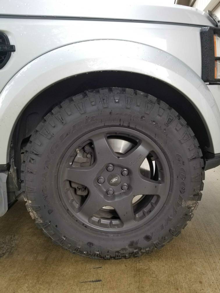

275/65 18 Duratrac on compos on a '13 LR4. Minor rubbing.
