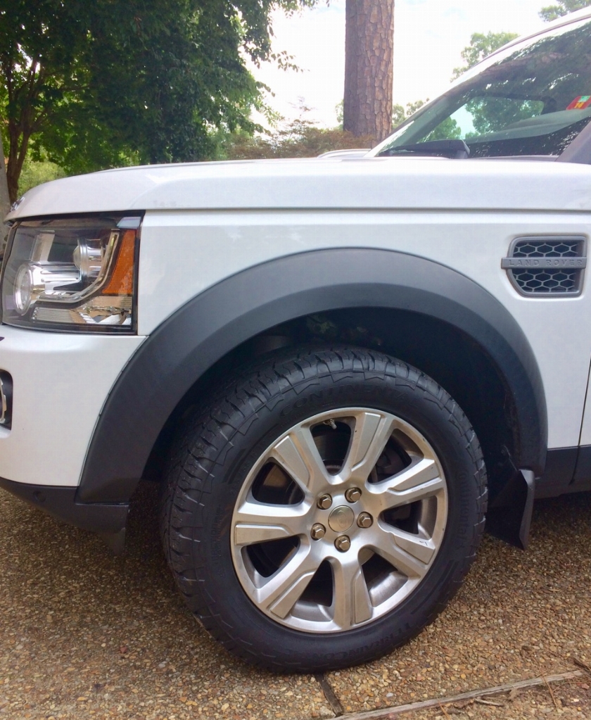

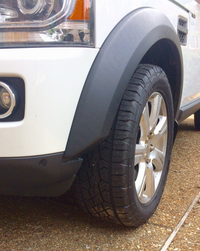

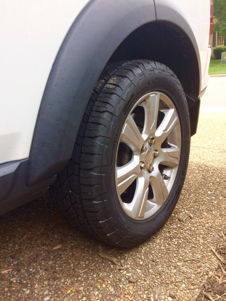

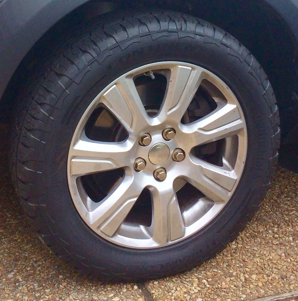

Just got Continental Terraincontact A/T 255/55 R19 mounted. Here are a couple pictures. Can't provide feedback at this time since I've only had them since Friday. Enjoy.

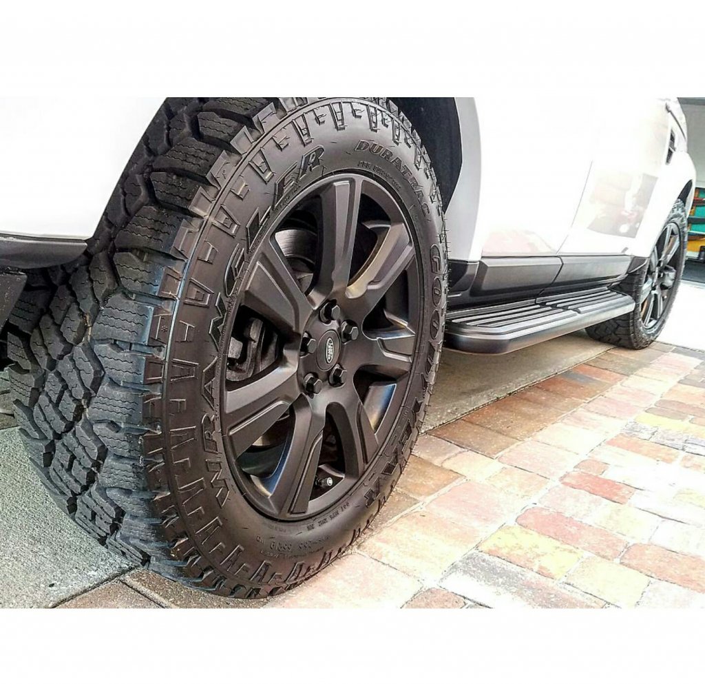

Looking for the GY Duratracs on a 19"?

Thanks, Brian. That's a nice looking tire and the beefiest I have seen in person on our 19" wheels. Even in your picture the sidewall seems too big for the tire size.
I'll have to consider those when I'm up for new rubber. If there is really a 1.5mpg hit on the highway, though, I may stick with a slicker looking tire. Love the aggressive look of those, though, with no trimming or lift mods required.
Are they lumpy after sitting a while? With the original GY OE on my '05, I found that the nylon belt would develop flat spots. I'd have to drive a bit to get them out after the truck was parked for awhile.

I've been really happy with them, I think they ride rather well but I only have the stock contis to compare them to. My dash currently says I'm getting 19.3 mpg, not sure where it should be, don't pay much attention. I haven't experienced any lumpy spots yet, I do know that they are absolutely amazing in the coquina sand though. Taking them through the mountains in a couple weeks when I go up to north carolina.

My wife has the Duratracs in 255/55/19 on her 08 RR and they are great tires. No flat spots, smooth ride. The only downside would be that they do hum on the highway and it does get louder as they wear. We have about 20,000 miles on them andd they still perform great in all conditions, she does not go off-road however. She does not even hear the noise (or does not care) where I do hear it, but its not as loud as most mud-terrain tires. We put them on right after getting the RR, so I do not know if the mileage is worse compared to the ones it came with....
