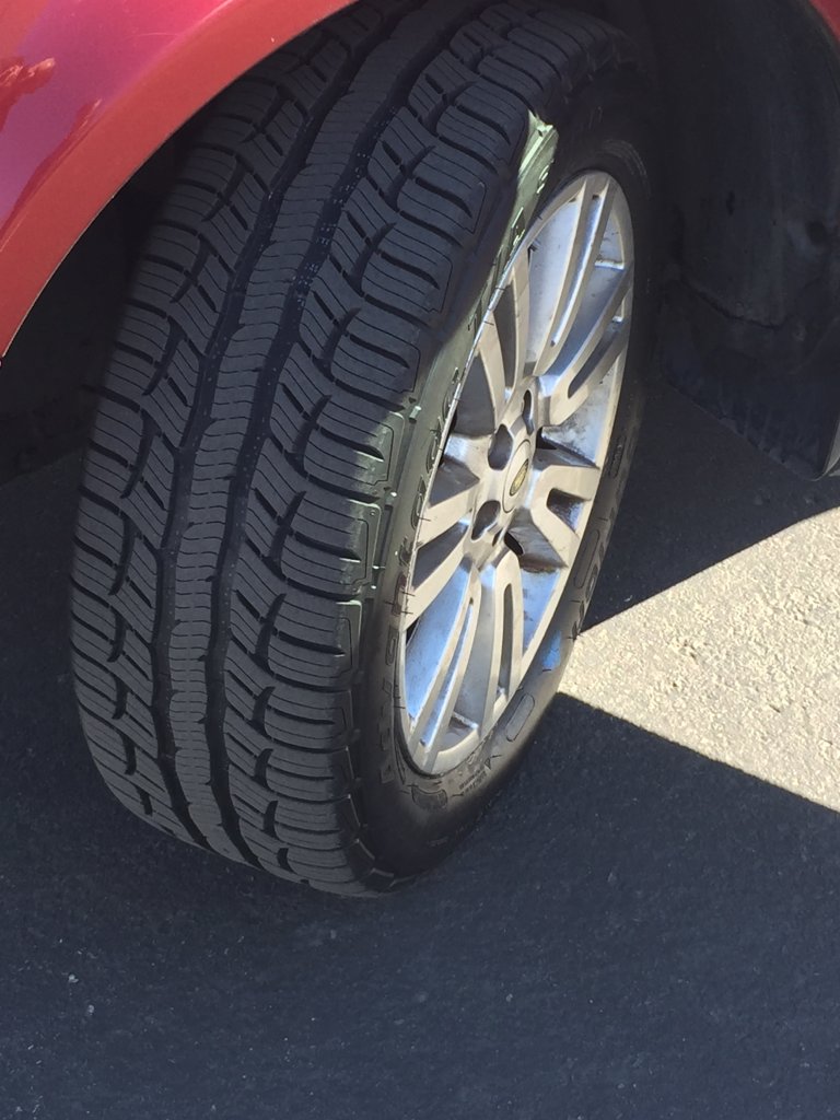

After a lot of thought, dropped the idea of the Duratracs/Zeons/TerrrainContacts. I have an LR2, and everyone I talked to said they were too wide and could rub. Not wanting to spend $1k and have them not work out, went with BFGoodrich Advantage T/A, 245/55R19. Got them at Discount Tire--the guy I worked with looked for quite some time to find them. Interestingly, none of the tire web sites show the tire in 19" unless you enter the size. $162 per tire, but with their refund/replacement g'tee, disposal, mounting, life maintenance, total was $867. Will be interesting to see how they work out.

These are the BFGoodrich tires I bought
