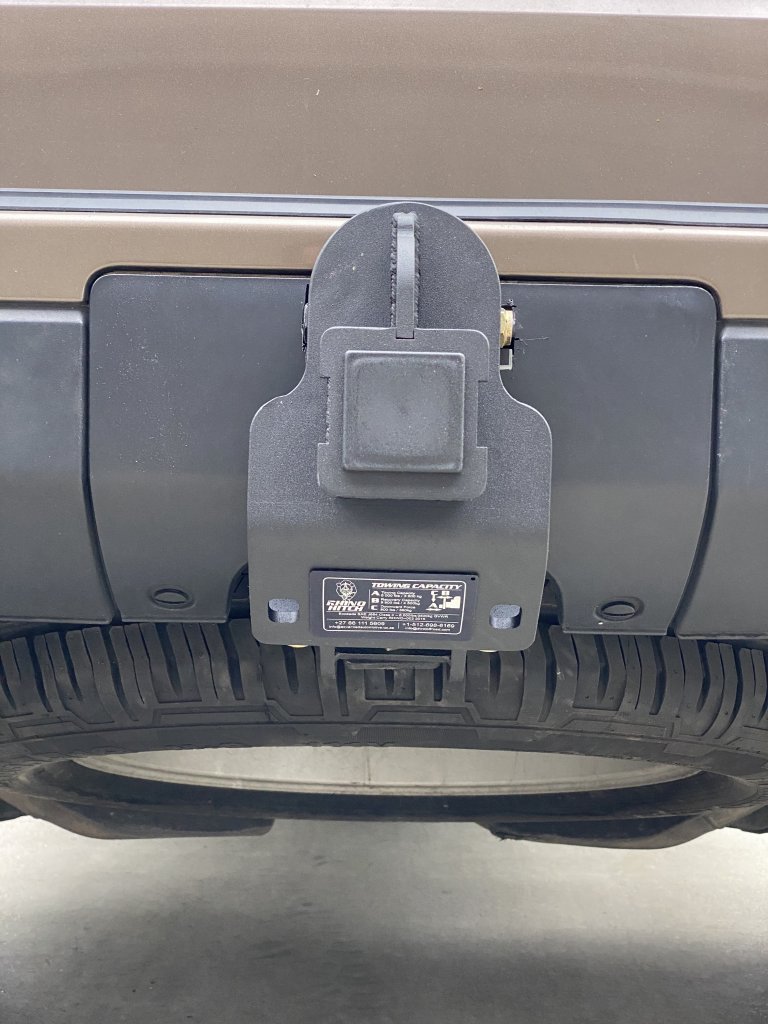

spodie
Jan 27, 2020
California
I installed the Rhino OX hitch receiver. It allows for bit more ground clearance. My only complaint is that it's not very deep. I had to take an inch or so off my hitch. https://www.snomasterusa.com/product/rhino-ox-hitch/
