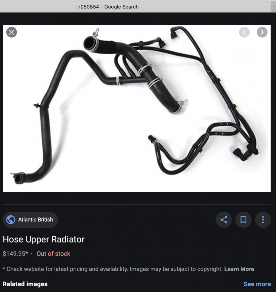

tangentially, LR050854, the upper radiator hose assembly, which i believe we had to mess with when dealing with the supercharger, was VERY brittle, and cracked a small connector on it. which they don't sell. you have to buy the entire birds nest for $133 (LR RENO). Really as an FYI, there are a lot of cooling system parts here that are stupidly brittle after only 75k miles. The crossovers crumbled on removal in my case at the base where it went into the block. i ended up replacing various other items on dissassembly beyond the crossovers, and discovered how not well they were holding up. Screen Shot 2020-05-29 at 9.11.33 AM.png

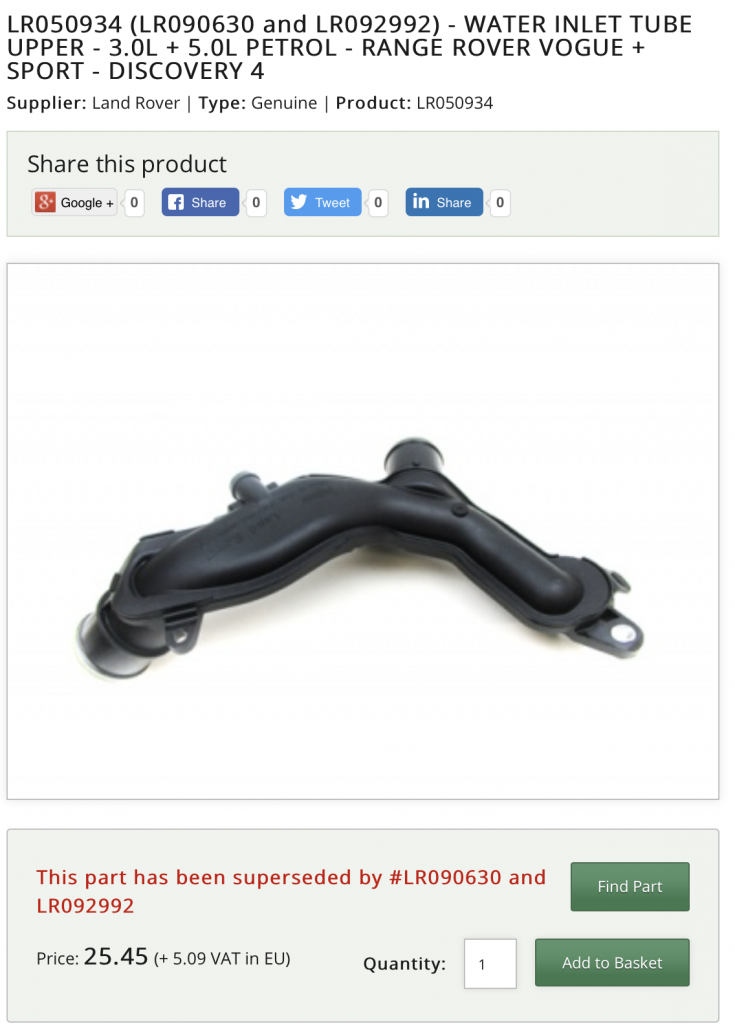

I think this answers the part number question. Screen Shot 2020-05-29 at 9.18.04 AM.png

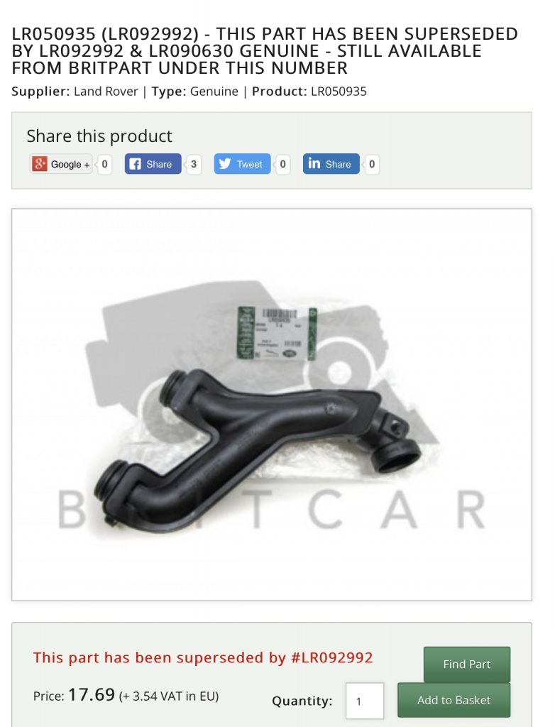

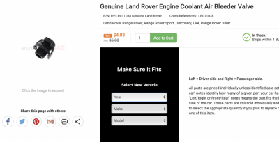

IN any case, don't forget the blanking plug - LR011038. Mine was too brittle to remove from the old and the new one did not come with it. Screen Shot 2020-05-29 at 9.21.36 AM.png

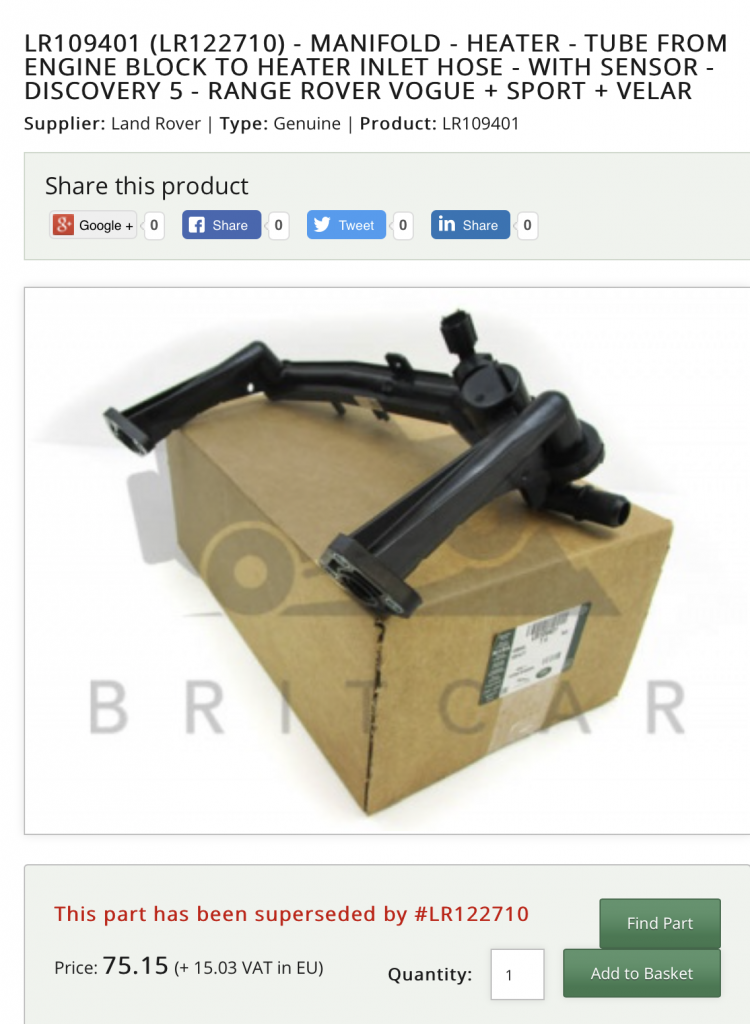

and forgot that i also replaced LR109401 at the same time. Screen Shot 2020-05-29 at 9.25.57 AM.png

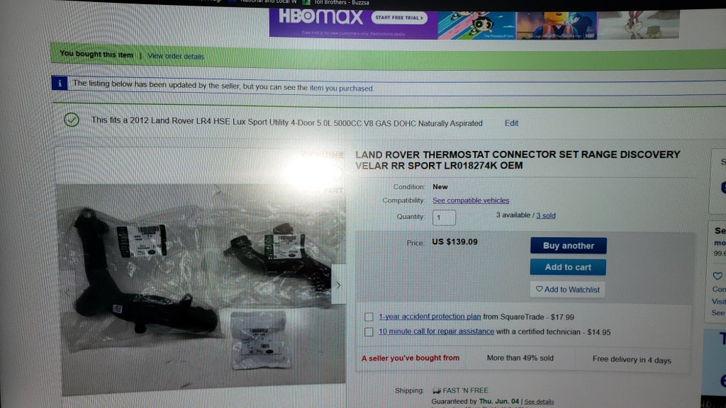

This is the kit I got
https://www.ebay.com/itm/174027247449
Part# LR090630 , LR050935 - water connector - THERMOSTAT TO TOP COOLANT HOSE
Part# LR092992 - WATER OUTLET TO CYLINDER BLOCK TUBE - INCLUDES O-RING
Part# LR011038 - DRAIN PLUG

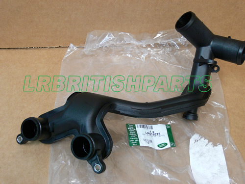

I must be missing something. I don't see how this would fit. The crossover pipe is the pipe attached to the head underneath the manifold and comes forward to where it piped to the thermostat no? How does this now part fit underneath the manifold? The old (LR018275 attached pic) cross over pipe was a that squashed, two half's seam welded together shape for clearance. Oh wait, mine is an 10' V8 might be different for the SC engine, sorry.
Interesting, as I was wondering the same thing.
Mine is a 2012, and the ebay engine lists it as compatible with a 2012. I did check that much before I bought it.
I guess we will see.
