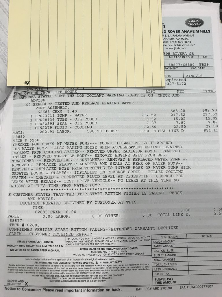

pabs406
Aug 28, 2015
69
Hello Forum Members! Can one of you guys take a look at the repairs that were made to my rig and advise if the parts that are known to fail were all replaced (I.e. the infamous “cross over pipe”)? Just want to make sure that I’m covered for now. Thanks I’m advance!
