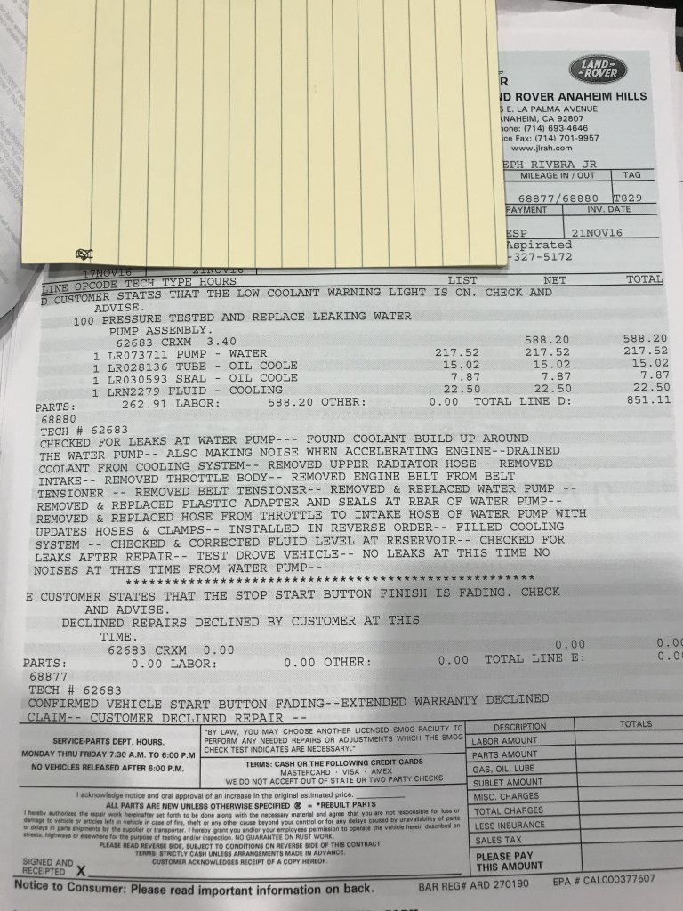

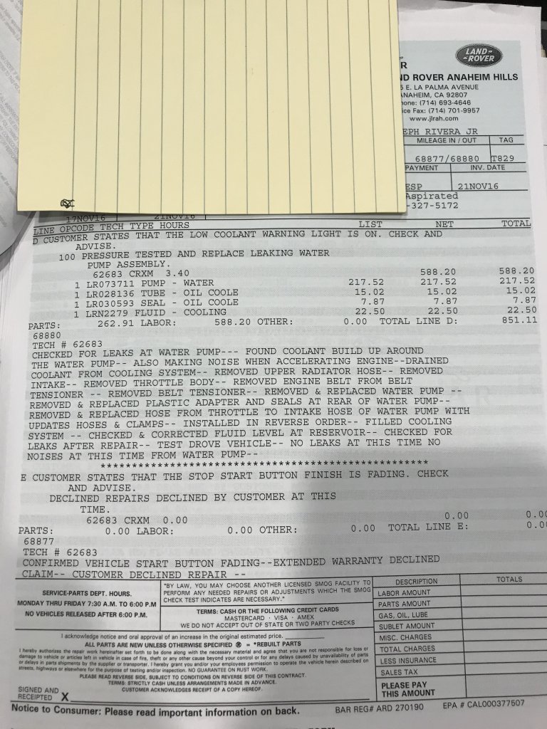

Hello Forum Members! Can one of you guys take a look at the repairs that were made to my rig and advise if the parts that are known to fail were all replaced (I.e. the infamous “cross over pipe”)? Just want to make sure that I’m covered for now. Thanks I’m advance!

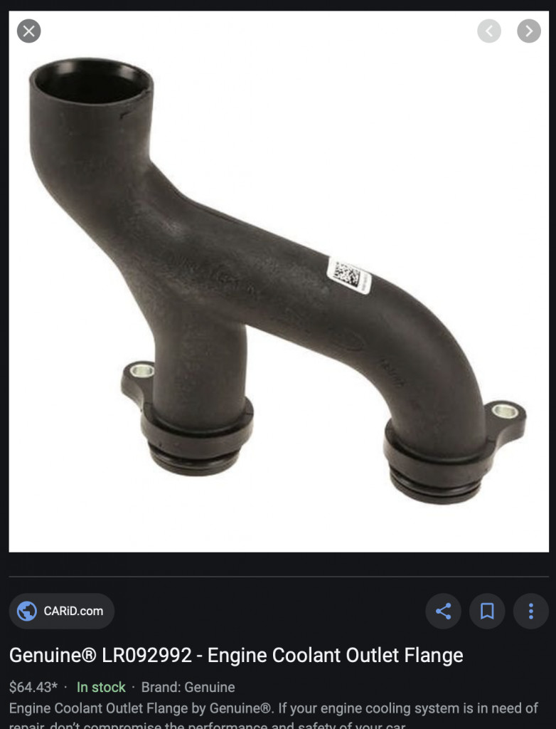

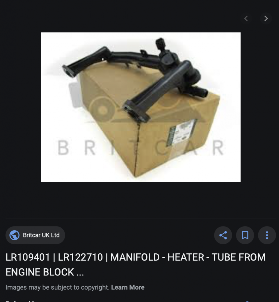

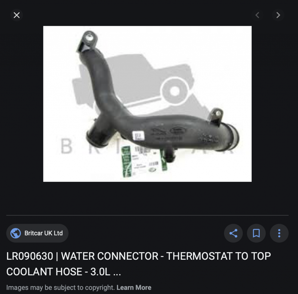

Neither front or rear changed. you need these. and some gaskets. Screen Shot 2020-05-27 at 5.25.10 PM.pngScreen Shot 2020-05-27 at 5.26.42 PM.pngScreen Shot 2020-05-27 at 5.27.12 PM.pngScreen Shot 2020-05-27 at 5.29.55 PM.png

Doesn't look like it. Looks like they replaced only the pump, oil cooler pipe, and oil cooler pipe gasket.
That's a bummer. A good LR mechanic would suggest replacing those with the water pump, because he knew they were risk items.

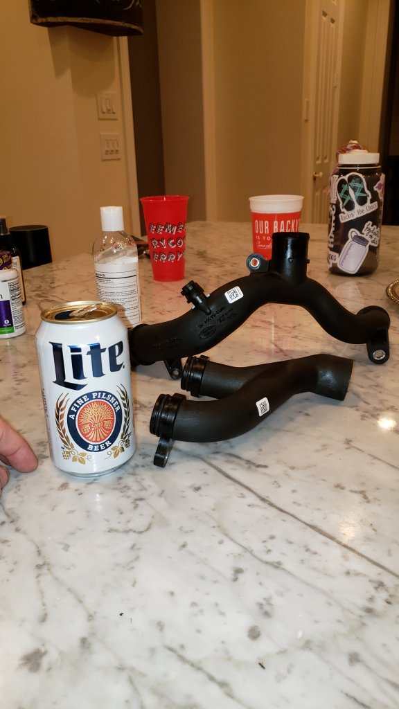

None for the pipes. The rubber o-rings on the pipes seal them. I forget what year your truck is though. If supercharged, the supercharger or the snout, and the water pump need to come off to get the "y" pipe off. Not sure if it's easier on the 5.0. With the water pump you'll need the water pump gaskets (2 of them total), the oil cooler tube and it's seal.
Alright, I got these. What gaskets do I need?
