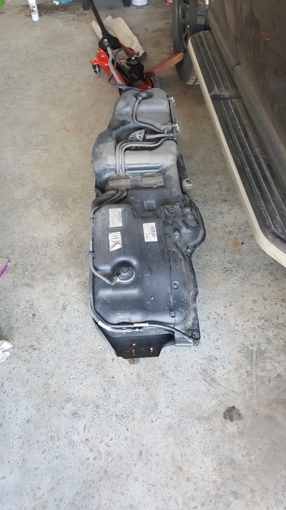

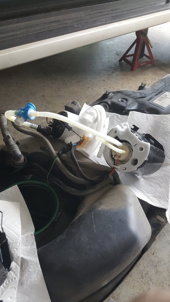

Lots of fun today. Fuel filter and in tank fuel pump replaced. It's all back together, but ran out of time to prime fuel pump and test drive it.

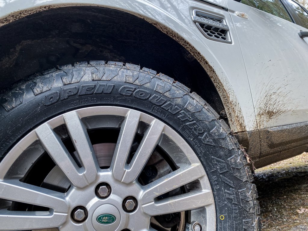

They're on my list, but my one reservation is that they don't really look any bigger than my 255/55/19 Cooper Zeons. On paper, they should have a half-inch more sidewall, but it doesn't look like it in pictures I've seen online.
I may just bite the bullet and get 18" wheels.

Can you tell us what led to this? I think I smell some fuel in the back of my '11, I'm guessing it's the filter. Does it make sense to do the pump as well?
It was part preventative maintenance and part troubleshooting. Personally, I would replace the pump while you already have the tank dropped. It's not a huge endeavor, but I would be annoyed if I had to drop the tank twice
