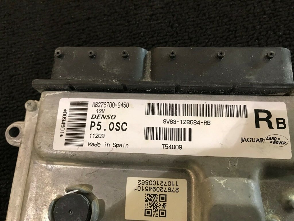

Appears the LR4 V8 ECU is a Denso unit (photo attached). Later V6 SC may be Bosch Motronic?
The RRS 5.0 SC ECU appears to also be a Denso unit, with the label 5.0SC instead of 5.0NA.

Another avenue I’ve been pursuing is modifying the ECU myself using the Ktag system. However, according to Alientech, the only file you can modify on the Denso ECU is the micro map file...or basically the fuel, ignition and timing curves, plus a few other odds and ends. Evidently, the immobilizer information is stored somewhere else. So, his recommendation was that when I receive my P5.0SC ECU, plug it into the LR4 and see what happens via the iLAND diagnostic tool. If everything shows up, it may be all we really need to do is edit the name of the ECU itself so it matches the name of the existing LR4 ECU. Truthfully, he wasn’t an expert on our ECU’s, but he mentioned it was really odd the way it’s set up.
