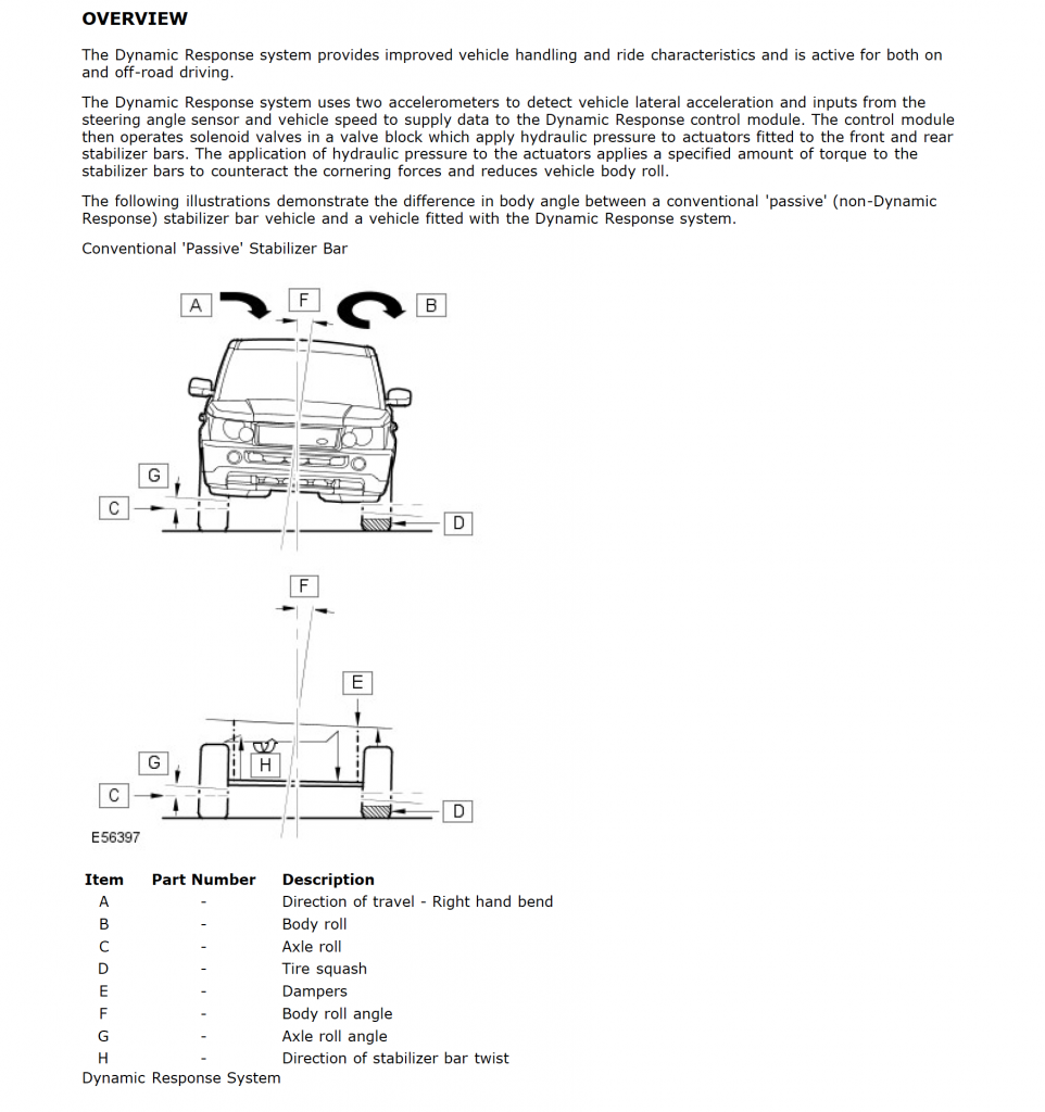

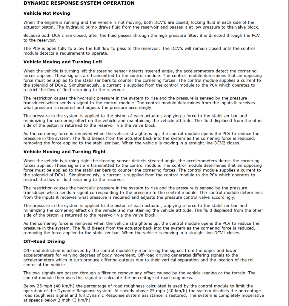

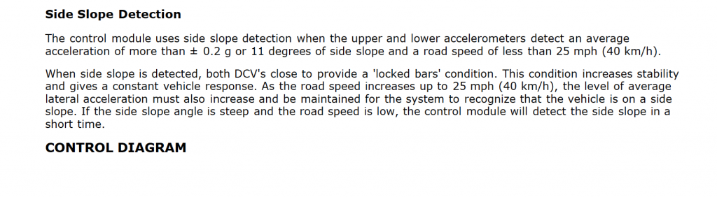

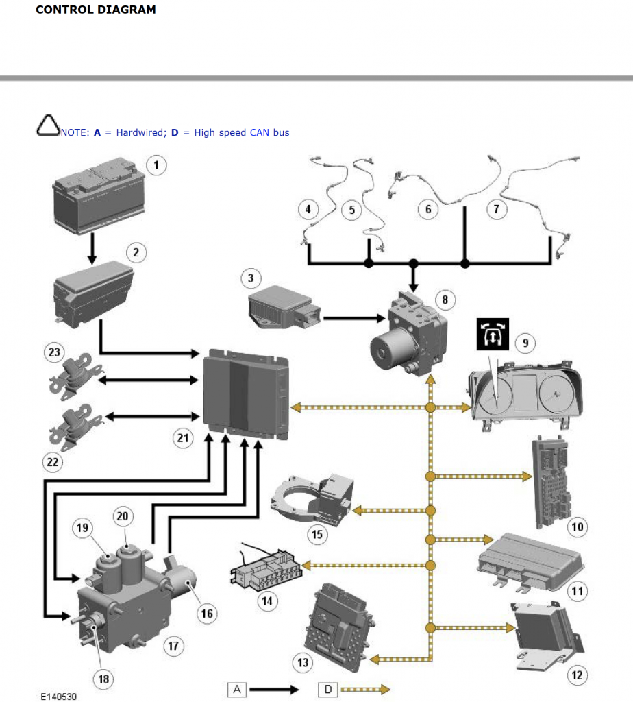

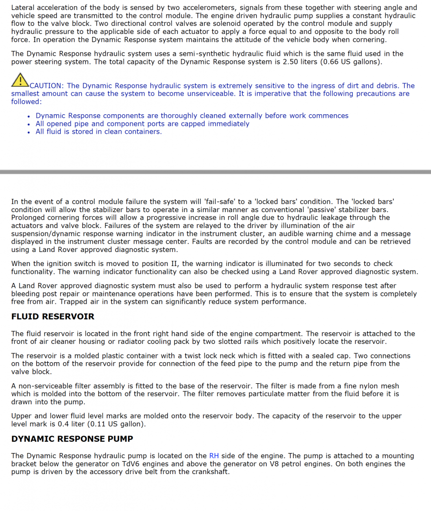

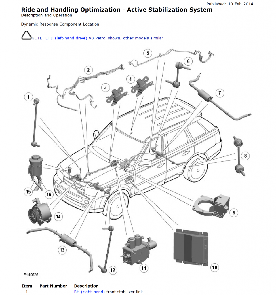

Ok, I thought I'd post what's in the manual about the adaptive suspension system. It's kinda cool, not gonna lie! Plus, the way it works, limiting the torsion like it does could be HUGE in terms of the LR4!
That said, the guy I got all my computer modules from already scrapped the donor vehicle....sooooo....not sure if I'll be able to put all the parts together to transplant. I'm trying to find another donor vehicle, but they're starting to get scarce! Plus, I'm not made of money, and these guys ofter want a ridiculous amount of money for the parts! We'll see though!
