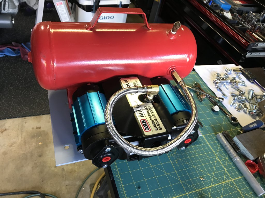

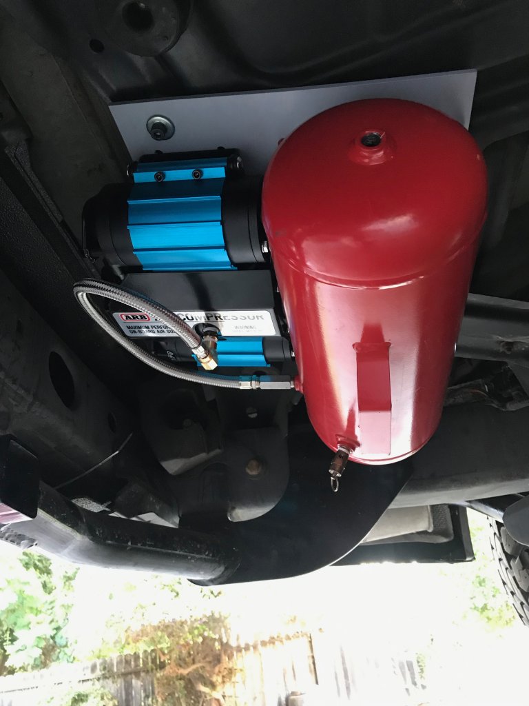

this might help some of You in your future add ons...
Due on my to upgrading tires I opted to eliminate the spare tire and winch in my Lr3. Having done that I decided to mount the arb compressor after exhausting any possible location inside the cabin or under the hood. (Knowing that I don't want it damaged by heat engine exposure, I considered the inside of the cabin but I didn't wanted to be exposed to prying eyes). so
the set up is very simple.... 1/4 aluminum plate tank
and air compressor mounted on to it. The whole thing get mounted on to the chassis of the truck.
View attachment 10070 View attachment 10071
How durable would that be off road? Are you worried about it getting punctured?

The location is pretty high off the ground , and the type of off roading I do...even to the extreme it will never touch ground. The most likely part that might come into contact will be the EAS air compressor as it protrudes below the frame of the truck. that's one of the worries that I have and I am considering relocating it to the back.
in terms of durability it should last quite a bit. There is a few things I am waiting on the mail to make it less noisy and should isolate the sound traveling thru the sheetmetal of the truck. This compressor is 15 times louder than the EAS as compressor but then again it also pressurizes to 150 psi in under 2 minutes as opposed to 35phi for the EAS. Not having it installed in the hood and keeping it away from the heat is better

I recommend trying to shield it in some way from road spray. I mounted the same model compressor in almost the same spot in a previously owned F250. Mine was between the spare tire carrier and the bed floor.
It lasted about 18 months before it died.

That is a good Idea, although here in communist California there isn't much of the white powder or salt on the road.there are other white powders but I am not getting into that subject.
