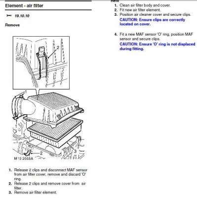

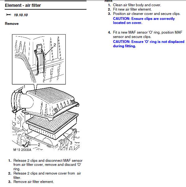

First things first download the repair manual it will save you money. http://www.landroverresource.com/
Second... here is where the air filter/air box is that will probably be full of water.

that intake box looks identical to the one on my range.... interesting, I haven't had chance to look at my brothers Rover but these pics basicly say it all! what a good resource!
