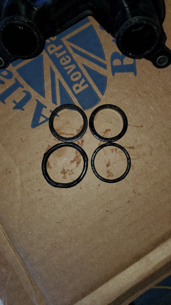

Those o-rings probably swelled up when the pipe was removed.
It would be difficult to install the pipes if they started off that size.

I only point it out because it matters in the context of people on this board trying to figure out how often they should do preventative maintenance on the item.
Yours is an extreme outlier data point, and I was just trying to determine why.
Good point. I'll look at the old pipe again, and see if there are any markings or numbers on it that may tell me where it came from. If I see anything, I'll report back.
My guess, based on how it looked when I took the pipe off, is that the o-ring got stuck on the edge of the hole when they inserted the pipe on one side (maybe they didn't lubricate it with coolant?). So it did not seat properly, and was stretched/pinched for its 30k mile life in the car, until the tubes finally broke. Note to anyone considering doing this job, pay extra attention to the o-rings when you seat the pipe. Make sure you use some coolant to lube them. Not sure if using any other type of lubricant is a good idea considering how sensitive these cooling systems are to contaminants. Maybe others with more experience can chime in on that.
I looked at the old pipe and it had FoMoCo stamped on the side.
