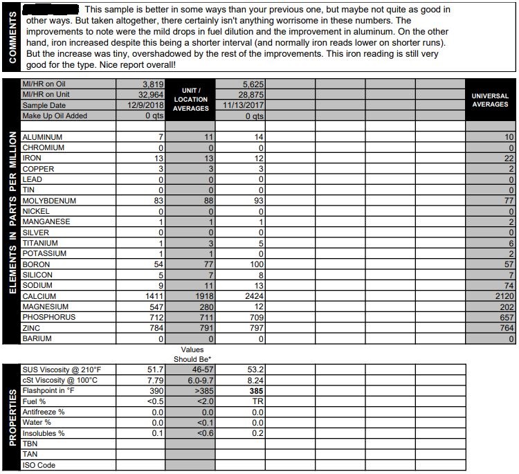

My latest Blackstone Labs report below:
1st sample is from my last Castrol Pro OE 5W-20 fill. Latest sample was from my first year using Mobil1 EP 5W-20.
Note that when and how the samples were taken matters. They recommend grabbing the sample half-way through the drain. I use a vacuum, so I suspect I have varying amounts of stuff that settled.
I had a particularly low mileage year this past year. I expect to be closer to 6-7k miles per year going forward.

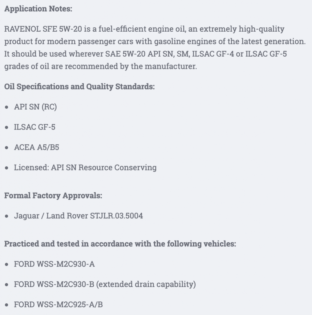

Don't recall seeing this brand mentioned before, but I recently came across Ravenol J1A1504 5W-20 which seems to meets the JLR standards. According to their website, they claim "Formal Factory Approval" for the Jaguar/Land Rover STJLR.03.5004 standard. May be a good alternative to the Castrol OE and is currently available directly from Ravenol's website and on Amazon.
Ravenol J1A1504 5W-20 Product Page
Ravenol J1A1504 5W-20 on Amazon

So is the STJLR.03.5004 standard a newer one that has superseded the old WSS M2C925-A?
I've seen some reference to it being an up-to-date spec for the AJ133 engine, but nothing formal.
https://www.bobistheoilguy.com/foru...373/re-jaguar-v8-5-0sc-engine-oil#Post4382373
I also found that Liqui Moly Special Tec 5W-20 is billed as "recommended" for the WSS M2C925-A spec. At $30 for a 5 liter jug, the price is pretty good too.

1,412
Don't get hung up on the 925 rating. It is simply a long life standard. Use a quality synthetic and swap it every 12 000 kms (8ish k miles). No fuss.

I've never found any formal documentation that clearly states M2C925-A superceding to anything else. Lots of speculation, no proof.
A lot of mfr's show their oil as "recommended for" a particular application, which is not the same as a true OEM/manufacter approval. My personal choice (Red Line) uses the term "Suitable replacement for" Ford WSS-M2C925-A. Red Line is a Group IV/V oil but not cheap at $48/gallon (free shipping at Summit Racing or Jegs, on orders over $99).
Note that any oil priced around $30 for 5 liters will be a Group III base stock; not a big deal if you are changing at ~5kmi intervals, but I wouldn't recommend it for extended drains or the FSM spec of 15kmi. I like Motul products too, and do use some of their stuff.
