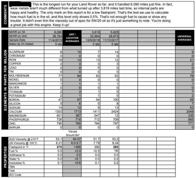

My latest Blackstone Labs report below:
Note that the first report shown was based on the last time I had put on the OEM Castrol. The last two are based on using Mobil1 EP 5W-20.

For the record, this last (3d) sample was taken from gravity-drained oil halfway during the draining per Blackstone's directions. The prior two samples were taken from the Mityvac.
